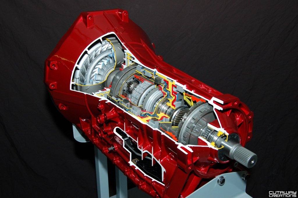

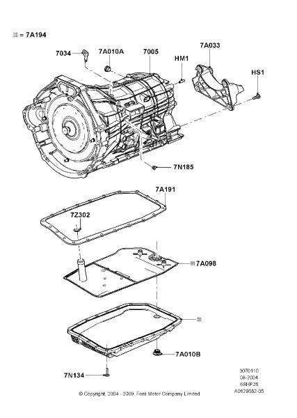

The link below is from within the file link I provided above.
The link is to what Ford calls their 6R60 which was their license built version of the ZF 6HP26 six speed in the LR3.
The 6R60 first went into the Raptor and then other of the body on frame Ford upper scale vehicles. The six speed has now been superseded by the eight and ten speed transmissions, also built under license from ZF.
