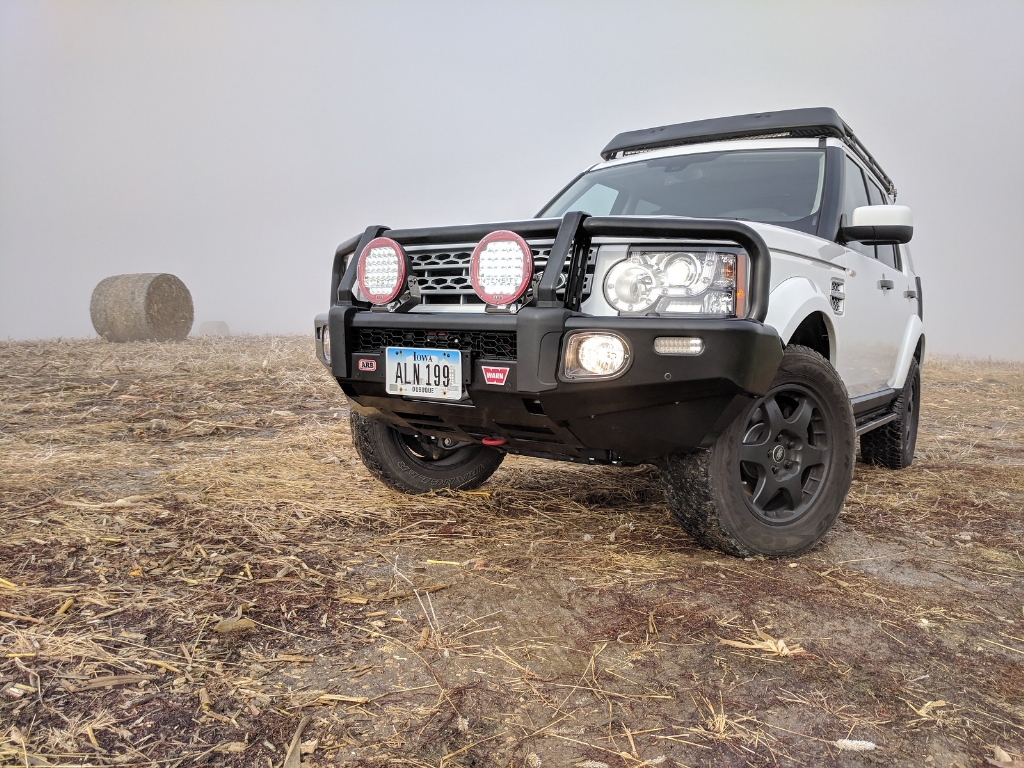

The Deluxe bar is quite different than the newer Summit bar. The summit bar is styled differently, has larger diameter bars and has better LED turn signal lights, better fog lights with covers, better split pan for ventilation and winch mounting.
AND IT WORKS WITH 2010-2013 LR4.... IGNORE ARB on the 14'+ thing. Only difference is the spray nozzles and the ones from 13 fit just fine, you just don't use the little spacer clip behind the bumper.
I have a Summit bar with all the goodies on my 2013.
ARB 3432220 Summit Disco LR4 (170 lbs)
ARB 3500720 WINCH INSTALL KIT SUMMIT BAR
ARB 3500590 51W Fog Light Kit - the lights.
ARB 3500600 Hawse Fairlead Spacer Kit
ARB 3500680 Clear Fog Light Cover Kit+
Warn W94288 Enhanced Signal Kit
Warn W92815 WARN Zeon Platium 10-S (75lbs)
Warn W89970 Short RELOCATION KIT FOR ZEON PLATINUM 31"
ARB AR32S/F ARB Intensity 9.5" SPOT driving lights (each) x2

ARB supports the parking sensors correct? If so this is going on my wish list. I literally just had a guy the other day ask me to push his BMW with my LR because he was stuck. I said no way without a real front end. I pushed him out by hand.

yes, the summit bar supports parking sensors, existing fog light and turn signal harnesses, headlight washer nozzles.

and also, the washer fluid tank mounts on a bracket that comes with the bumper. Nothing about the washer system is an issue. im not sure what was being said before about that.
