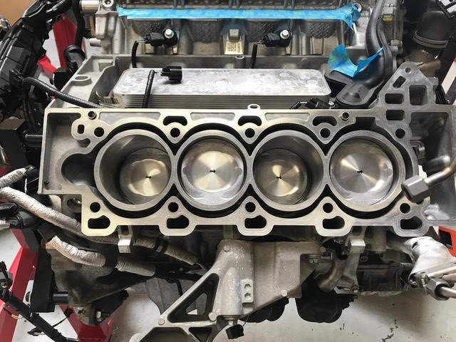

I’m curious about head replacement, can’t you just take them to a machine shop and have the milled like older aluminum heads?
It's been a long time, but didn't you generally replace pistons to account for higher compression after milling heads and decking the block?
I seriously doubt there are alternative pistons for the JLR block.
I'm going Beck at least 30 years since I was around that level of hot rodding, though, so memory could be failing me.
djmalachi
Apr 6, 2009
According to my guy, by the time the head gasket has issues, lots of other areas "disintegrate" making machining/resurfacing/redrilling/etc particularly fun.
"that level of hot rodding", that would be a basic blueprint engine building even for a bone stock low compression and horsepower engine like a 1960's 170 cu/in Falcon engine.
Swapping rods and pistons around to get equal piston deck height (piston crown to deck of block the same as rod center line to center line (big end to small end) do not usually measure out the same. Add production errors or lack of quality control (LR) even wrist pin center line to top of piston (piston compression height) can have different measurements.
Longest rod with shortest piston compression height will hopefully cancel out deck height errors. Hell within 0.010" (0.254 mm) milling down the piston top 0.010" then making all pistons weigh the same then you will have an engine with equal compression ratios all cylinders as well equal quench area. Must add all combustion chambers cc checked and made equal volume which production engines are not unless machined chambers. Cast production chambers, LR and other manufactures as example are "close enough". Basic engine rebuilding also know as "blue printing".
Milling a warped head for a flat surface to block, what happens to the warped head's cam journals now not running straight and true with the straight (hopefully) cam shaft now secured into the warped head? Boom comes to mind, big $$$$.
Depending on how much material is removed or "skimmed" to regain flat heads and block shouldn't increase compression that much besides these engines already have anti-detonation sensors retarding timing until detonation is no longer detected.
Worse yet now the cam journals to crank shaft journals are now closer together after "skimming" or required more material removed off the block deck and heads hence the timing chain slippers have to extend themselves out farther to compensate for the extra slack in the timing chains. Is there enough allowance by the take up with the slipper's piston tension ******? Second problem now forcing the slippers to maintain a larger deflection arc in added degrees, thinking now added and accelerated wear on the already crappy failing slippers?
BTW I helped a friend with his LR4, located a pair of good used replacement heads, total cost including gaskets, head bolts plus fluids under $800 up and running again. That or give it a "mystery electrical fire" burn down.
I posted that adventure about a year ago, used donor heads off a clean running engine with light tan carbon deposits all eight combustion chambers. It was a smacked in the rear totaled donor vehicle. Shop around Pick-N-Pull yards, worked for us.
Open deck blocks a added reason why head gaskets fail in general vs any closed deck block what i've noticed over the past 50+ years wrenching on engines......~~=o&o>........
