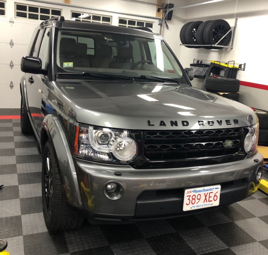

I just detailed it last night. I'll take a photo of it soon before it gets dirty again. Looks pretty good considering it is our main winter car here in New England.
Last evening a big t'storm rolled in and rocked some awesome lightning/thunder/downpour. Just before it started I backed the LR4 out of the garage for a free rinse. Once all the weather drama was over, I took my gin and tonic out to the driveway and squeegee'd the Rover off then pulled back inside. Doesn't everyone do that??
After a trip from Boston to Cincinnati and back it would take a tornado to remove all the bugs that are glued to the front of my LR4.
I can't believe how good the paint is holding up after 105K miles, including winter weekend trips to VT. Even more amazing is how nice the leather seats look with zero wear spots.
