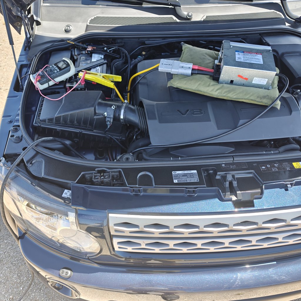

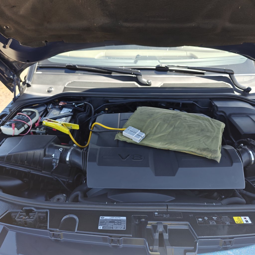

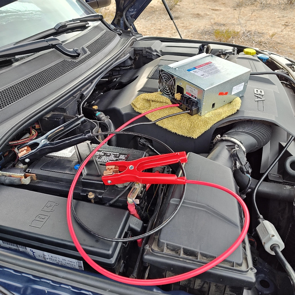

I made improvements to the charger for the starter battery by picking up some alligator clips and wiring. Its a lot easier to connect/disconnect the charger. I'd like to hard wire an Anderson connector to the battery and fasten it in the big space on the front passenger side. There was a post the other day emphasizing to use a body ground. The alligator clips don't work well with the negative post and I tried looking for a body ground but didn't see one in the area and all the metal parts were painted. Does anyone ground to the body when doing jumps or charging? Where do you connect the ground?

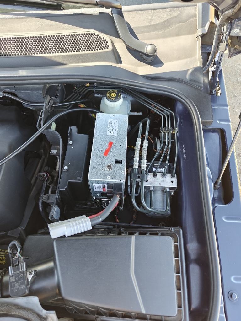

I made some upgrades to the charging setup for more convenience. Now the connector stays with the battery and the hood closes one step. Just the charger moves back and forth from a DIY Lifepo4 pack to the AGM.

Every day while overlanding I have put the charger on the starter battery while I'm at camp. I ran a test to see how long it would take to **** the battery since I started to get OCD idealizations and wondered if I've just been wasting time and energy. At the 1.5 day point it read 12.3V. Then I opened the front door and I heard the computer monitors flip off which was abnormal. I did business and then checked voltage after I shut the door and the monitors were still off and it read 10.4V. I couldn't believe it. So I tried starting it and clunk, not going to happen.
Aside from that, while I'm in the back cargo area, engine has been off for a day or whatever, I'll hear a fan kick on near the rear passenger side and behind the plastic interior panels. It also has fans behind the fuse box and those will run for several minutes even after the engine is off. I think the heat has a lot to do with the extra energy it needs compared to everyone else where they let it for weeks and never have a problem.
To streamline charging, I was thinking about buying a dedicated charger and mounting it where people put the ARB compressor or 2nd battery. The benefit is I don't need to carry it in the back cargo area. But in the cargo area is a Lifepo4 battery pack and inverter already so if I'm at a swimming hole on the river way out in BFE and it doesn't start I could just plug-in the charger. It sounds good, but I need to plan it all out because if that thing catches fire or interferes with the existing electronics in some way even when AC is unplugged, then I'll have more and bigger problems than when I started.
