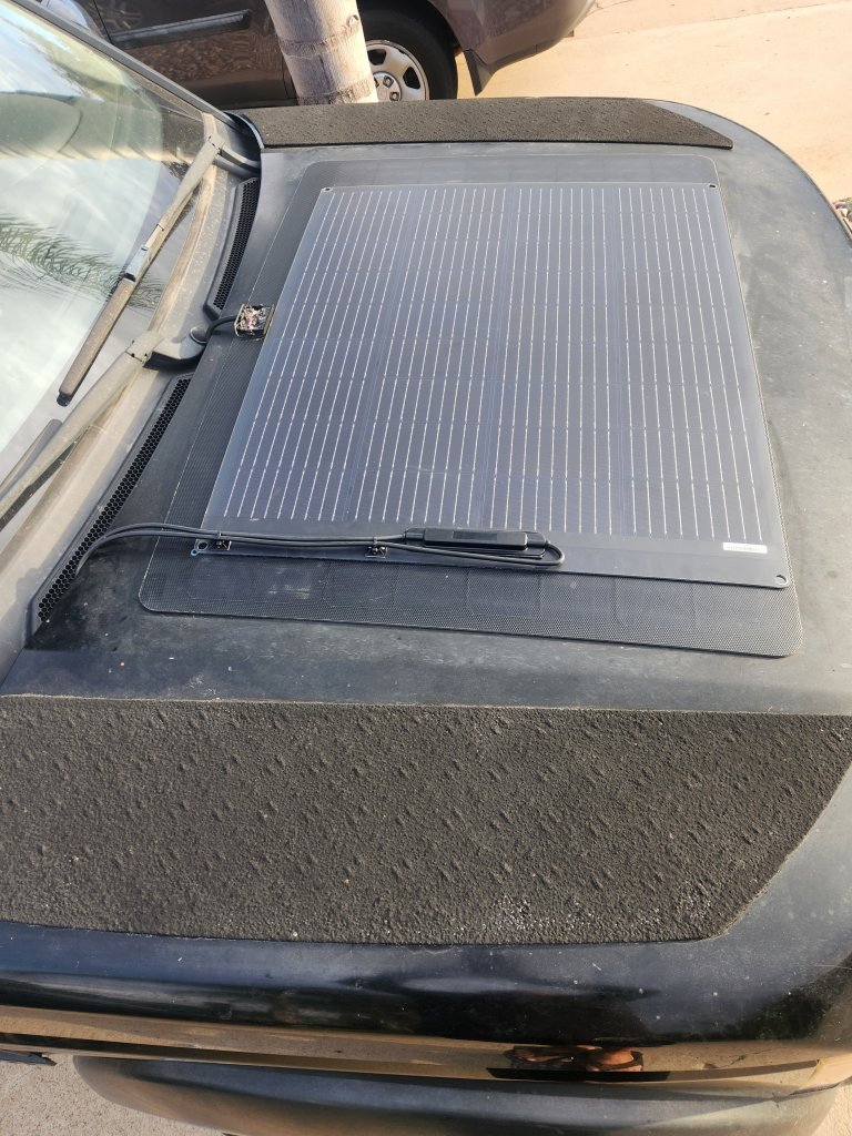

I helped Lensun with the very first LR3/LR4 hood solar panel fitment. The first panel was off by a lot hitting the spray nozzles. The first one that fit correctly, I still had to dremel the nozzle holes. Anyhow, that $400 hood solar panel slowly died under a year and completely died 1.5 years later. I was offered a 30% discount on a replacement when I first reported it. I said all that to say, don't get the Lensun version.
I ended up relocating my spray nozzles to the wiper arms and fitted a cheap $75 Amazon special on top of the broken Lensun panel on the hood. Looks clean enough and it works. Don't mind my dirty truck.

Thanks for the feedback on the Lensun, that's unfortunate. Solar panels should last a lot longer than that. Hopefully the Cascadia 4x4 is better. Did you change the wiper nozzles when you relocated them, and are they still heated?
Unfortunately, it's not heated any more. I live in Southern California and I rarely have a use for it to be heated. Up in the snow, I use my heated windshield. So, I'm not too concerned about using my windshield washer.
