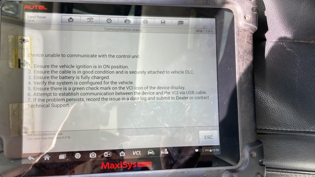

I suspect a faulty ECM on my 2015 LR4. I have the following symptoms:
  1. Overheating. I suspect the ECM is not energising the electric thermostat. The upper radiator hose is never hot.
  2. Viscous fan is always engaged.
  3. No communication with the OBD socket. See attached picture. I have confirmed 12 volts on pin#16.
  4. The amber warning indicator light in ON. No engine light.

At idle, coolant temp is normal for about 45 minutes, then overheating rapidely. I can't monitor actual temperatures of ECT1 and ECT2 because no communications via the OBD socket .

To my understanding, the electronic thermostat is still primarily a thermomechanical mechanism that, in addition, has a heated wax element that the ECM can use to open the thermostat a bit faster when desired. But, the thermostat will still fully open in response to rising coolant temp and a malfunction in the ECM should not cause overheating.
You might check to see that the electrical connection to the viscous fan control unit is sound and that there is voltage at the connection. You mention that the fan is on; however, I believe the fan will run even when the electrical control is not working - it will simply run at a set speed and will not increase in response to coolant temperature changes. It probably wouldn't make much difference while driving with good airflow through the radiator, but it might be cause overheating while idling at a standstill for 45 min.
I don't have any clue about the OBD. I'm not familiar with the Autel systems. Have you had it working with this car before? Have you tried a different scanner (even just a cheap one) to see if you can get any reading - rule out a problem with the scanner itself?
