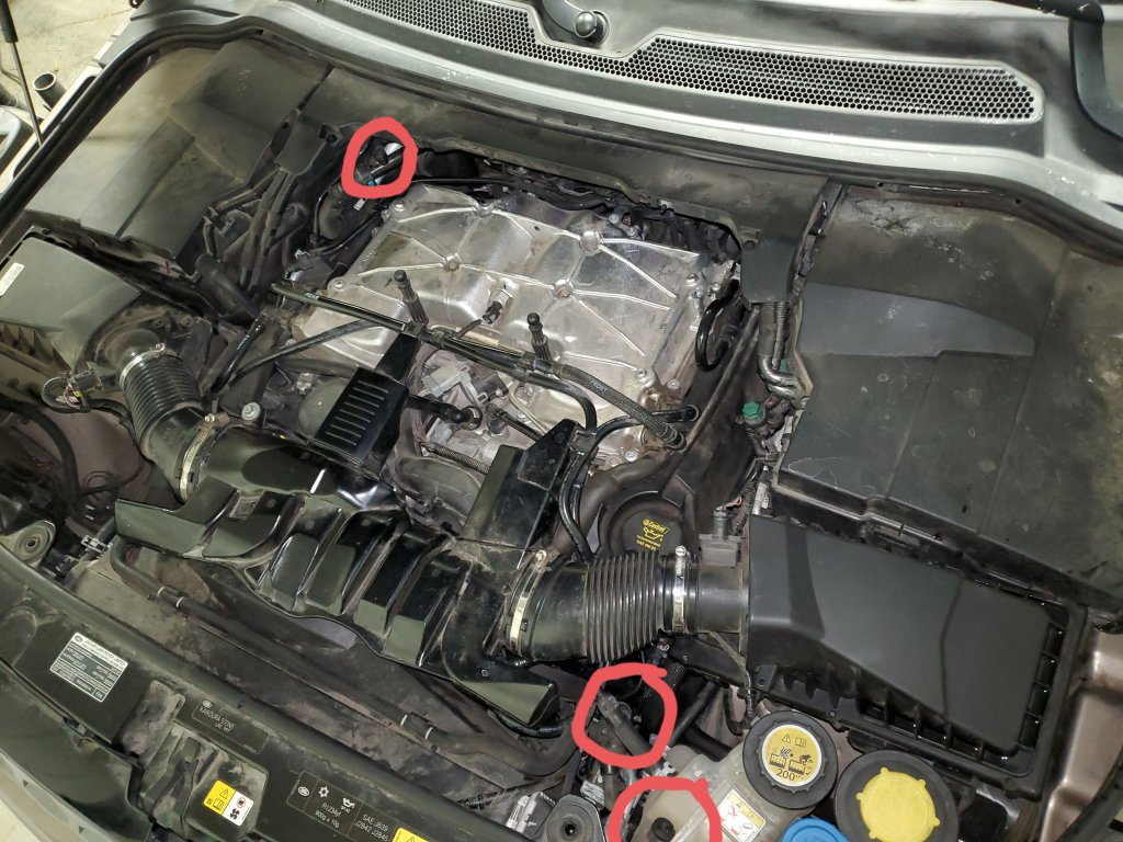

I did not have a chance to try again because I was unable to find the fourth bleeder valve. I will keep you posted.

I couldn't find the forth bleeder valve. Any ideas? I circled the three I have found.

There is a bleeder on the crossover-pipe. Right dead center in your image. More like a cap that pops off rather than a screw type bleeder.
Word of caution, though - if you haven’t replaced that crossover tube, the plastic might be brittle. You probably should get an extra cap/plug from the dealer before you use this bleed point (they’re about $7 as I recall).
You might be able to get it to bleed out just using the other three points. Not sure, but might be worth a try first.
In the procedure I used, that crossover was the first bleed point (engine off), the firewall was the second bleed point (engine off), the expansion tank bleeder was left open perhaps to allow air to escape the tank - but I don’t remember fluid ever coming out, and the bleeder on the radiator hose was the last bleed point (engine running).

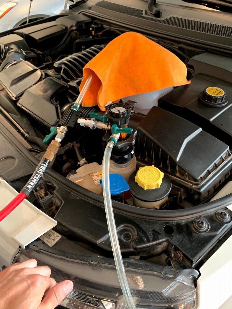

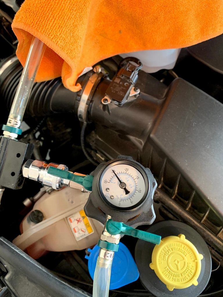

I can't believe people even try to bleed like all this ^^ ..... its nuts. Just get one of these vacuum filler tools. It seriously takes me 5 minutes total to fill my coolant after I drain it. I have never touched the bleed points on my engine... ever. Plus I am sure the system is leak tested and nothing is busted all in one step.
You drain from the lower radiator hose, put that back on, slap the tool on, draw vacuum, put the hose in a bucket of coolant, open it up and it fills to perfect level... done.. no fuss.
I looked that over a few times thinking that might be the forth but it looked different than the others so I bailed. LOL. I will definitely give that a try and maybe buy a new one just in case. Much appreciated.!
https://www.amazon.com/OEMTOOLS-244...ols+vacuum+fill+coolant&qid=1603834427&sr=8-2
I don't doubt this saves time but no more than I plan on doing this (never again) I won't get my money's worth. Thank you for sharing the link just in case I give up on the old school way.
