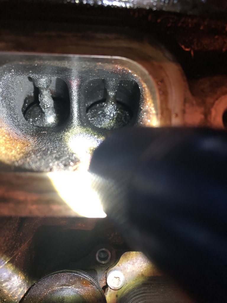

Leak down results
2 = 89% 1 = 90%
4 = 25/50/75 3 = 81%
6 = 85% 5 = 94%
8 = 99% 7 = 83%
#4 was concerning. One of the intake valves was leaking all the way around the sealing edge. First pass was 25% so I cleaned it the best I could and then it went to 50%, cleaned once more and cycled a few times and got 75%. The thing I noticed when cycling through the firing order a few times was a clicking noise from the bank 2 valve cover. Once the valves on #4 jumped from fully open to half-closed. This can't be normal. I haven't pulled the valve cover yet. Intake valves were pretty dirty.

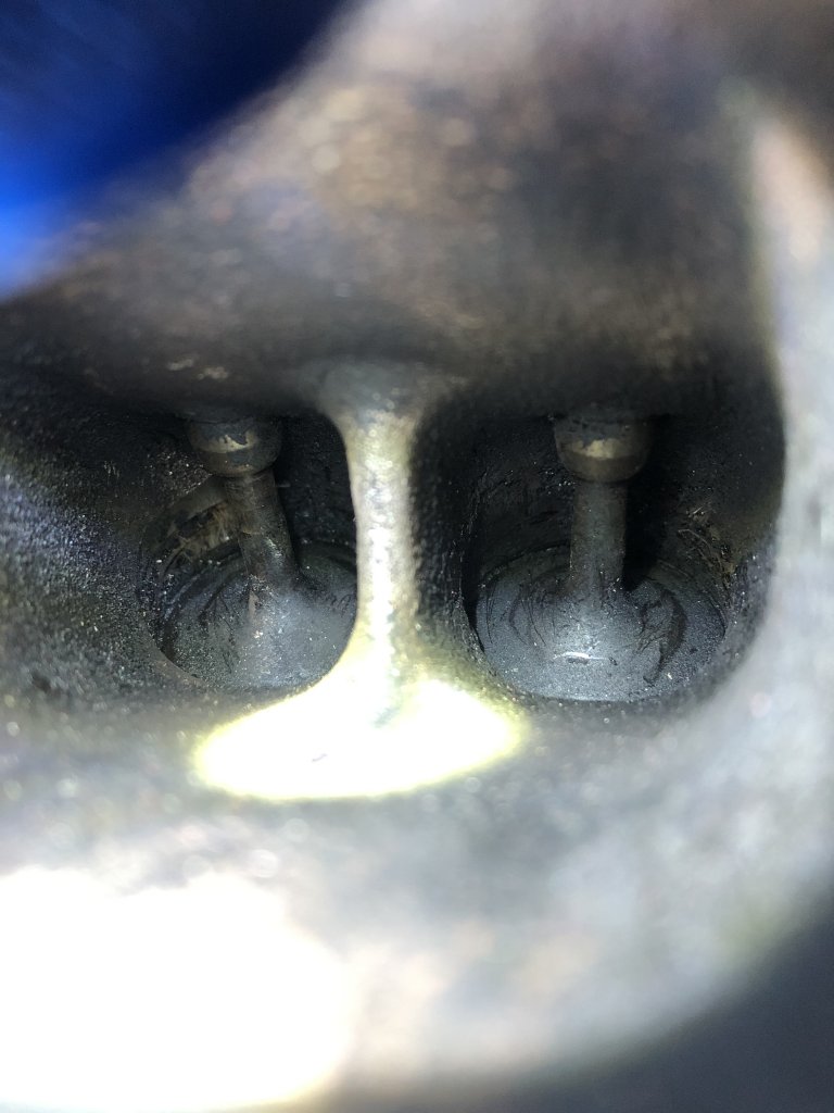

With the valves closed, I cleaned the valve with a plastic scraper to knock off the large chunks of carbon and had a small vacuum tube down in there to clean it up. I then used air intake cleaner to dilute the rest and vacuumed it out. I saw the thread about walnut blasting as an option as well. If i can get this thing running again I plan to run a cleaner through the intake that will hopefully clear up any small deposits lfet behind. My objective was to remove the large debris.

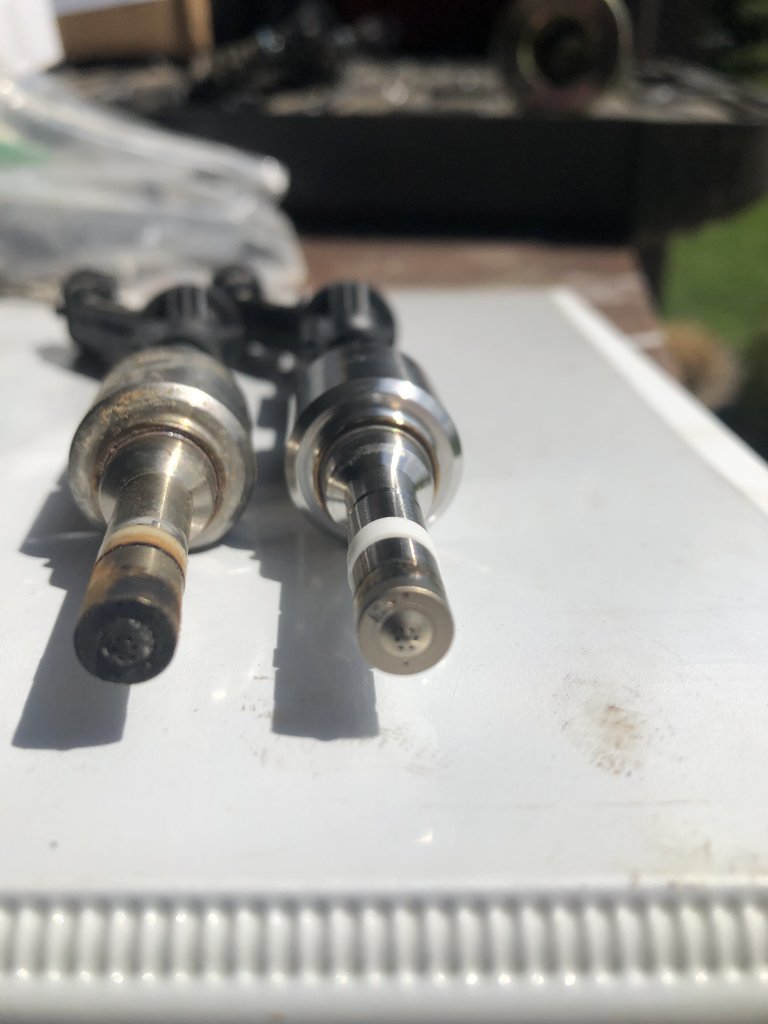

As a follow-up to my issues. I put everything back together and it ran fine again, for a couple of tanks of fuel. I added seafoam the first tank and BG44 the second. The next tank was premium only and my misfire immediately returned. I pulled the codes and again it was 1,3,5,7 misfire. I pulled the trigger and bought 4 bosch injectors from eeuroparts.com along with thew clips.
https://www.eeuroparts.com/Parts/187708/Fuel-Injector-0261500298/
I already had the battery tray and heat shields removed from the previous work. I waited to reinstall them, glad I did. It only took 1.5 hours. I used a similar method to pull the rail as others using a jack. I also used the injector puller to pull and reseat the injectors. Pretty easy, max ten pulls to get them off.
Runs great now. Acceleration is back. It always felt like the clutch was slipping under hard acceleration and all along it was misfiring, but not enough to throw a code. Glad I found this forum. All in all, I replaced my coolant pump, radiator, radiator hoses, thermostat, front and rear crossover tubes, cleaned my intake, intake vales, changed plugs, changed 4 injectors.
I was the one walnut basting and found it to be the only real way to clean them up safely. I walnut blasted, vacuumed, and wiped down with electric cleaner spray (what I had on hand). Harsh dissolving chemicals are typically not good for your intake and shouldn't be poured onto the the valves to clean them, so I'm told. Either way, good job! You got it running again!
As a note, direct injection causes a lot of carbon build up on the valves. The valves cannot be cleaned through gas lines. The workshop manual recommends running bg44k through the intake phlegm. I forgot the intervals, but I'm assuming at least once a year.
