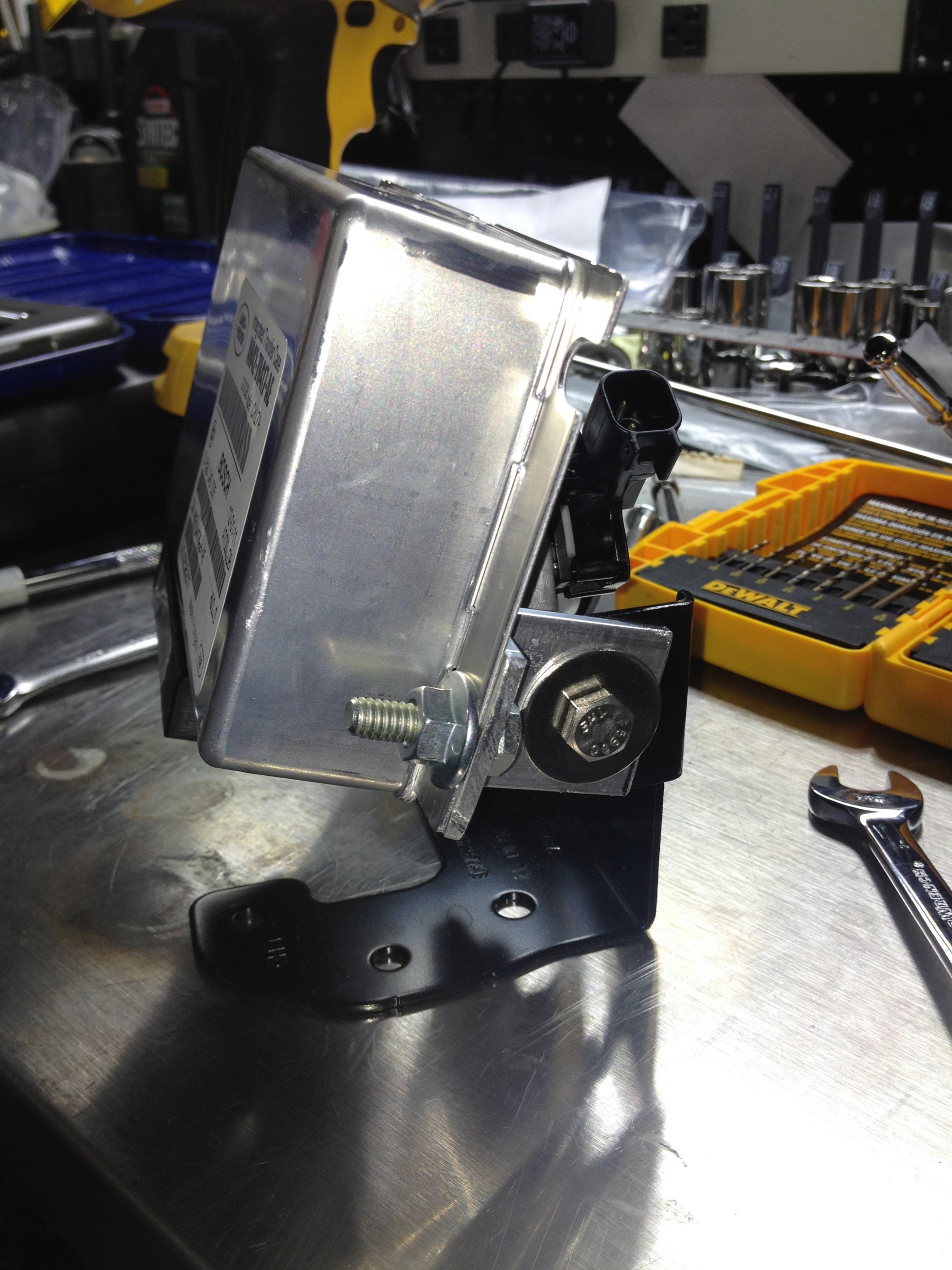

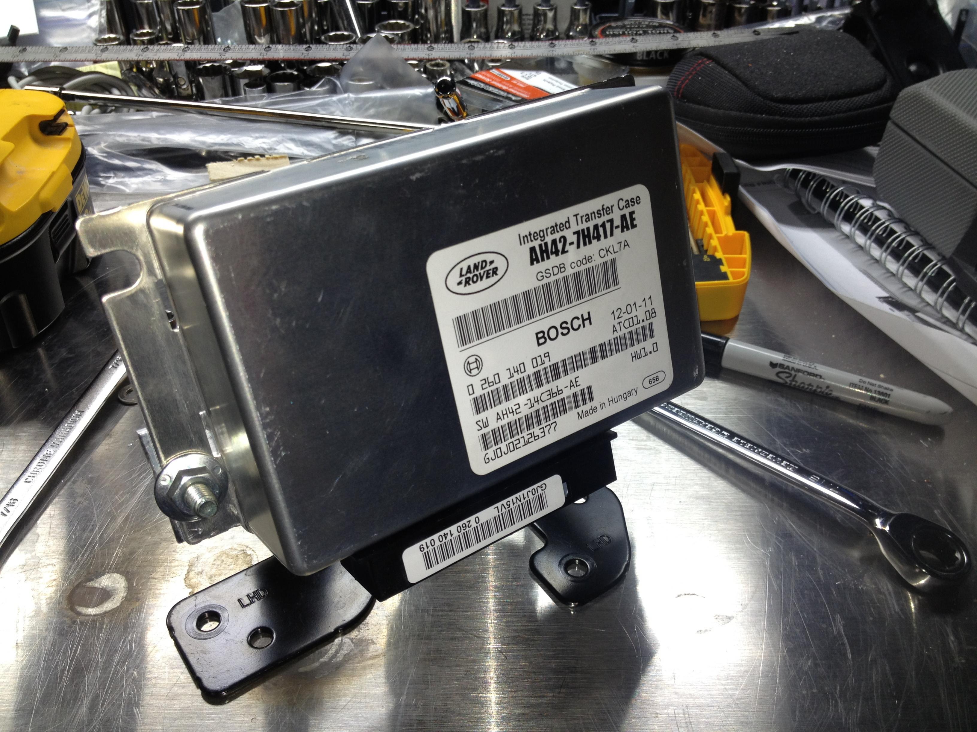

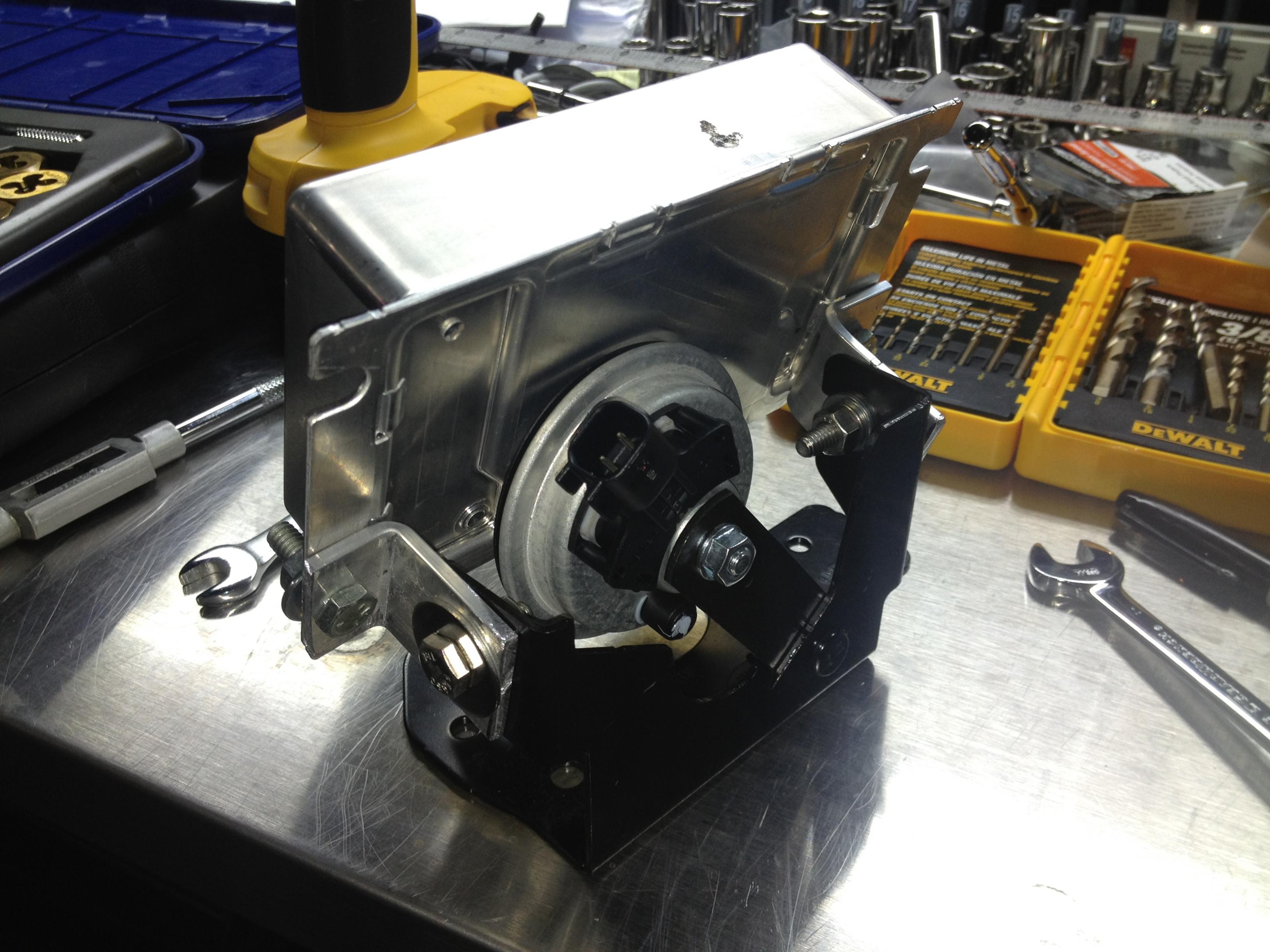

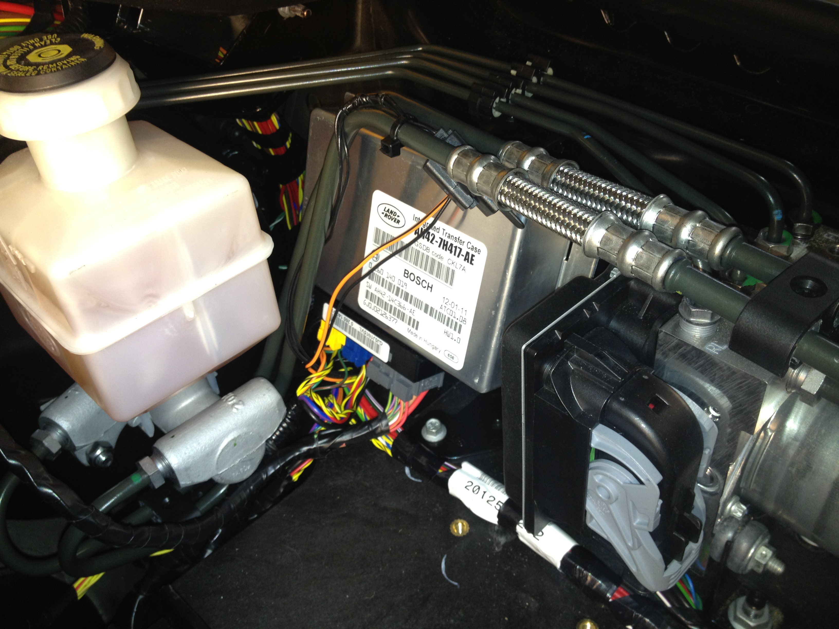

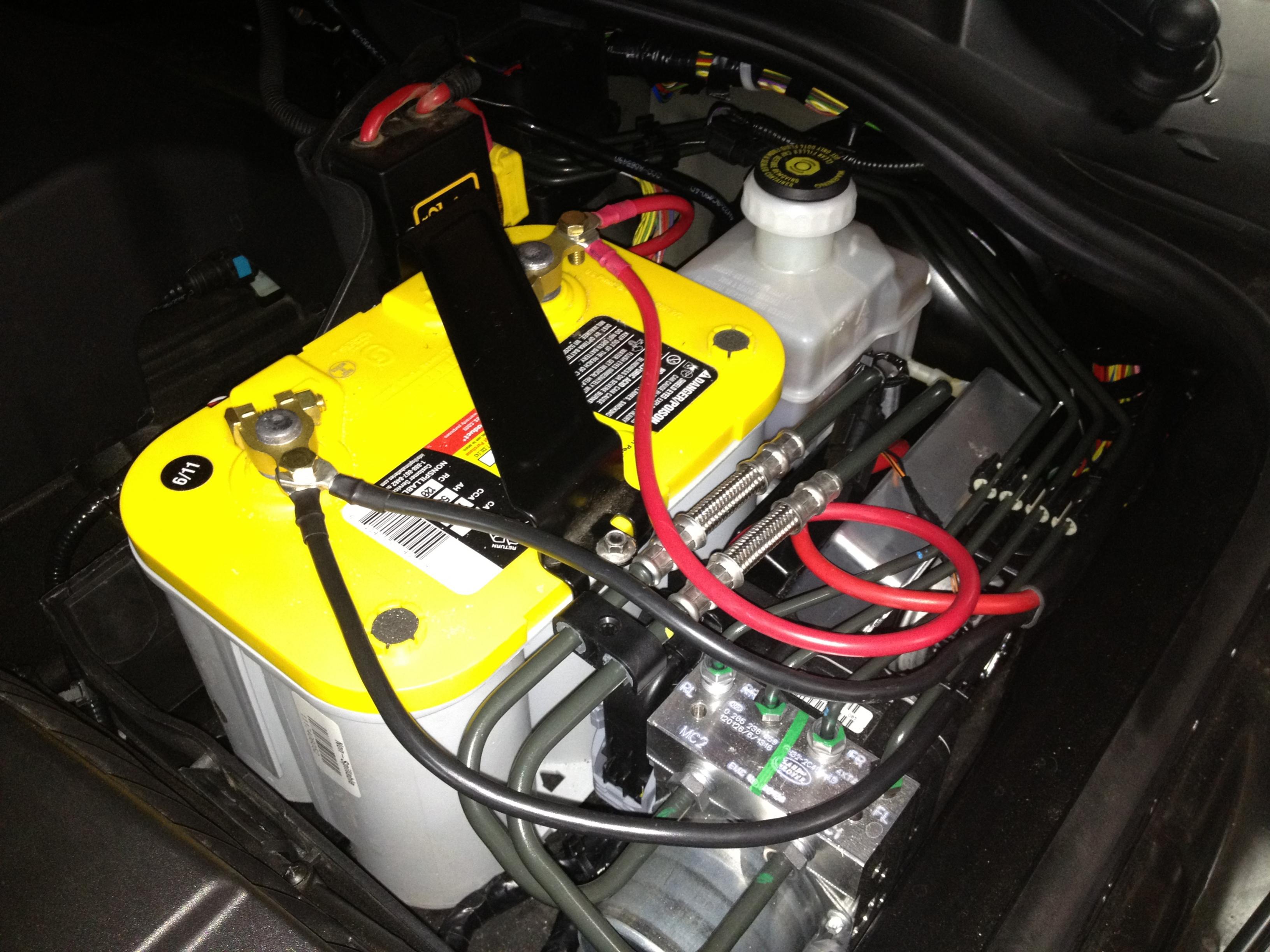

Hello everyone! Guess this can by my introduction to the board. :) I've been a long time LR and RR owner and have recently purchased a 2012 LR4. My previous LR was a 2008 LR3 and it was a great vehicle. So, getting to the point of the thread I was a little bummed to find that LR had filled the second battery box with a bunch of stuff in the LR4. Before I purchased my truck I shot pictures of the area and compared them to what was in the LR3 and determined that I could move everything out of the way and keep everything intact so I could revert to OEM should I ever need to sell the truck down the road. So, here's a few pictures of the install and where I relocated the Transfer Case control unit to accommodate the second battery. The rest of the install was basic to how the LR3 was run. I'm using the Traxide LR3 full install kit running to the rear of the LR4 for power to our ARB cooler. BTW, the ARB coolers are amazing and also highly recommended. Anyhow, here goes!

What size/group battery did you use? I should receive my traxide kit this week.

How is your install working? Have you had any problems with the ECU exposed?

@LRJ No problems whatsoever. I didn't think I would since the Transfer Case Control (which is what this is, not the ECU) was exposed in the LR3. Its still in the same battery box so its pretty well protected from the elements. I've even had my truck wading pretty deep without any adverse effects. I plan on shooting more pictures of the ARB Cooler install which slides out and the tread plate that its mounted on this summer. With this setup I can still use one of the rear 3rd row seats which has come in very handy on family vacations. I'll get the pictures up on this thread when I setup my truck for Summer. Rover On!
