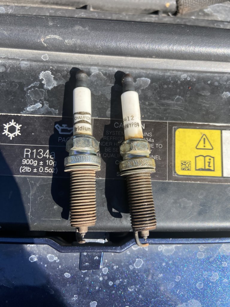

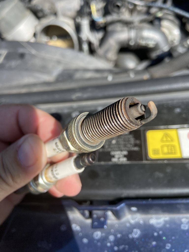

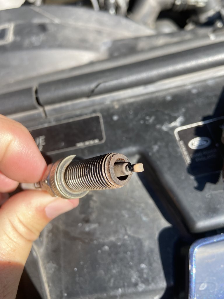

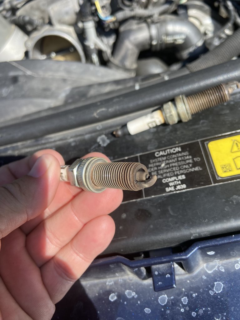

Pulled my plugs to chase down a misfire. I’m not sure what the coloration means, can someone help me figure this out?
Cyl 6 has a small amount of liquid that smells like fuel. I’m guessing I’ve got a leaky injector…

I agree @ktm525... Champions are terrible. I personally prefer Denso over NGK, but that's my personal preference. I like the Denso Long Life, but you'll have to gap them to 0.040". Otherwise, they're pregapped.
Get new plugs in and see if the misfires go away.

While not excessively difficult, the spark plug job on an LR4 isn't exactly a breeze, either. Boggles my mind that someone would go through the trouble of changing the plugs but use the wrong parts.

How many miles on your rig? Those plugs have been in there awhile and we know they are at least the second set (not original).

They look good. You want them to be tan as that indicates the correct air:fuel mixture. If you smell fumes there is a leak somewhere.
