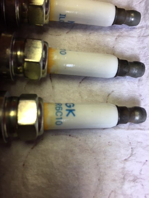

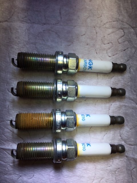

Here's my post (with photos of the old plugs) from when I did mine at around 100k miles:
2,637
1,296
It's a straightforward job and I disagree about leaving them too long. A couple of mine had rusty threads and backed out with some resistance. I would worry about them eventually corroding themselves stuck. At a 130k miles you are at least 1/2 through the expected lifetime of the engine. Keep in mind the NGK plugs changed a heat range from what they left the factory flor with (V8s)
Here are the old ones at about 100k miles. 6C10 came out. 7C10s went in

When you talk about heat range are you sayings the 6c’s are worse then the 7c’s are? I do have a 2010 so id think some of them are probably starting, if not, slightly corroded already.
6C10 are not available. They were replaced by the 7C10s
