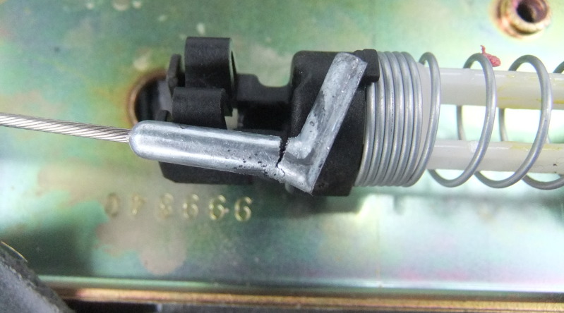

I regard the rear hatch will not open as a major fuss. The fix is not too difficult once you know what is wrong and have the hatch open, but that is the problem.
The link below shows some pictures of what is inside the lower half.
First off, all the moving parts are in the lower half so the trick is to get the black carpet removed from the lower half and at the bits without damaging the electrical wires that are hidden within.
Since you can sort of hear movement within, my guess is the gear motor that pulls the cable is getting tired or the L that holds the pull cable to the gear motor is broken. Either way, the fix is a new one.
There is also the possibility that the rubber switch near the license plate has to be replaced; for me, it was both, but not at the same time.
If you can hear movement, but cannot get the rear hatch to open, there is one trick to try - that is getting the system voltage up to give the gear motor more power. This assumes the problem is a tired gear motor and not a broken cable L. You raise the voltage to the gear motor by not turning the engine off, but letting it idle and then push the rubber button at the rear.
The upper hatch might just release. If so, then get busy and remove the carpet panels on the lower hatch so even if you have to close the rear before you get parts, that at least you have access.
Also there are the rear hatch release buttons on the front dash if the problem is the rubber switch - which is an easier fix - just pry out the switch and install a new one.
https://www.disco3.co.uk/gallery/thumbnails.php?album=4155

Now that you know how to take it apart, why don't you just replace that little puller "L" with a loop of cable permanently attached and crimped in place.
After two failures on my LR3 rear hatch, I made the change and never had an issue again.
