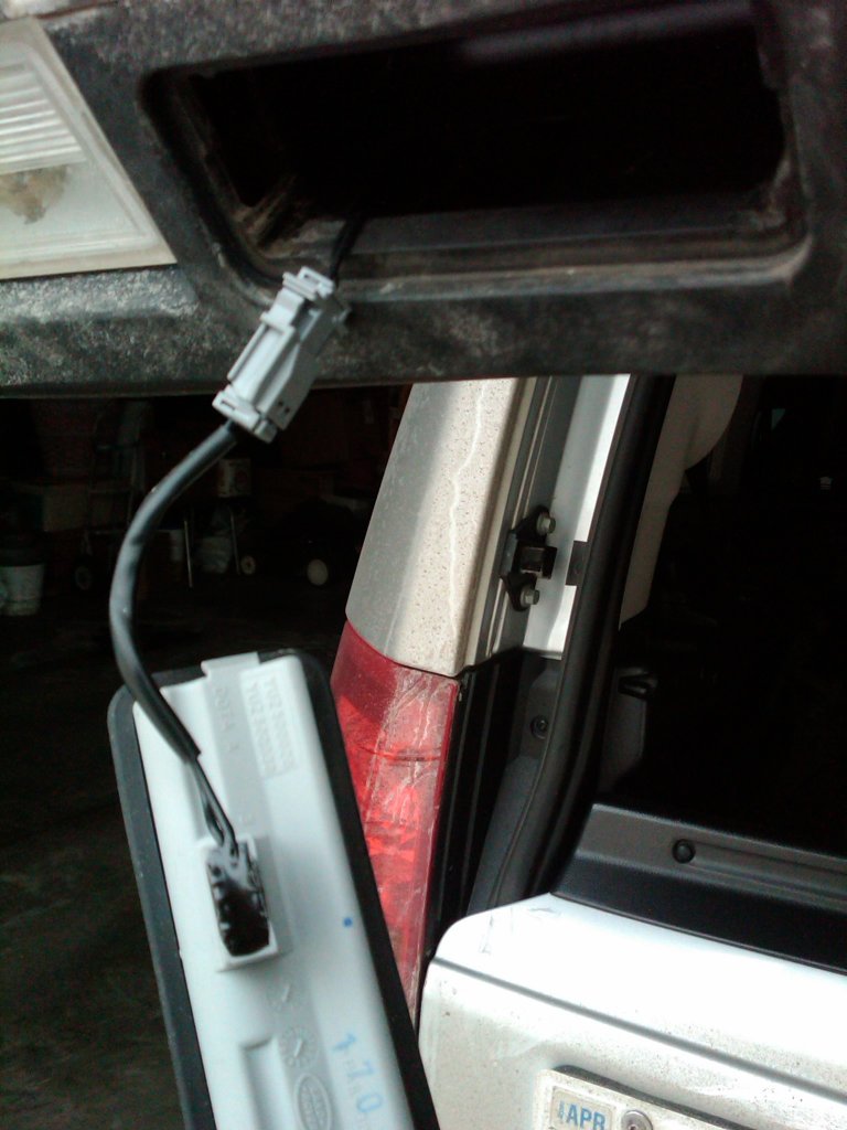

I suggest that before you head off to the dealer, first remove the switch mechanism from the upper hatch. The link below and the attached has pictures and links.
The rear hatch switch assembly unclips and pulls down and out much like one of the license plate lights when you want to replace a bulb.
The switch assembly is on a plug so unplug and see if the problem persists. If the problem goes away, probably a new switch is the solution - something you can do yourself. In brief, the switch can become corroded internally from road salts etc; hence failure of such is not unknown.

Thanks everyone for the reply. I took it to the dealer on Monday because I have extended warranty. They found that the tailgate release switch had an intermittent internal short to ground. They are replacing the switch and tailgate release switch. $2039.57CAD in Parts. Looks like they replacing the whole tailgate handle.
