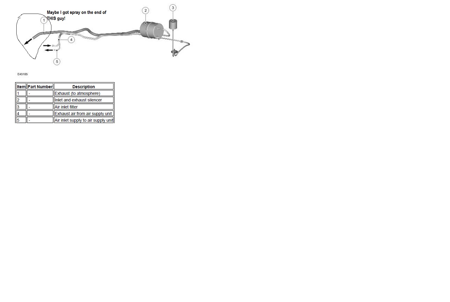

Anyone know where the circled hose termination lives?

No idea mate but perhaps tomorrow I'll visit my indy (he's still got my LR3 as the replacement compressor is not yet here) if I do, I'll ask him.
The sketch makes it look like it is somewhere below the driver seat NAS
Thanks...one other schematic shows the air filter at the rear of the vehicle so I think maybe it's back there.

Houm, I'm pretty sure that pipe comes down from the air intake filter (located in the cargo area near where the rear a/c unit is) and terminates in the compressor box (comes down and ends just above the compressor.
Not sure where the rear a/c unit is. If I don't have 2nd row climate control would I have a "rear" A/C unit? Certainly one end has to terminate at the compressor box....but the end that is "open" to the atmosphere, where the exhausted air would have to go out; where would THAT be? (the part that is circled on the image)
