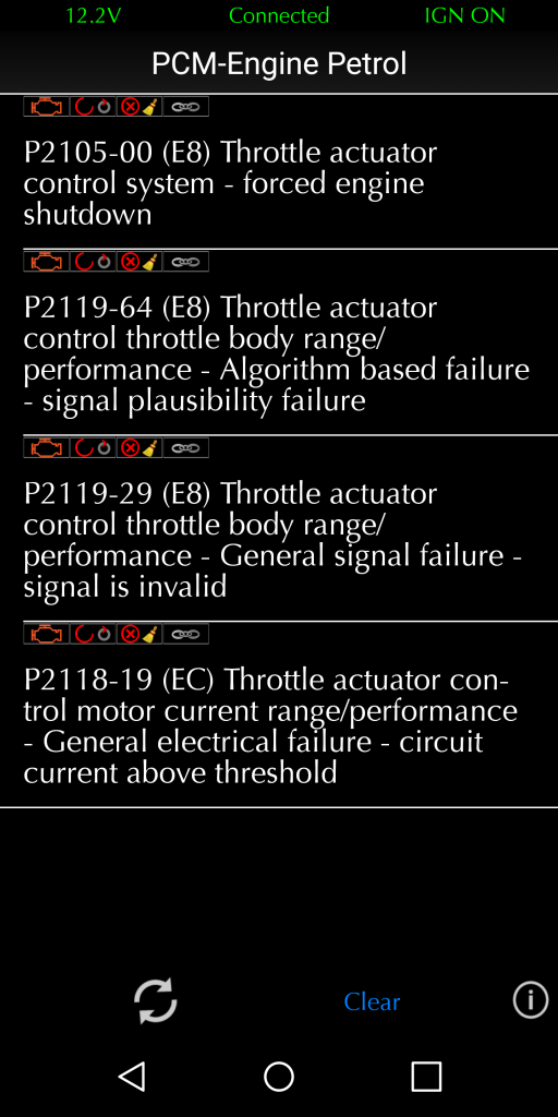

Anyone have experience with these codes? I get the restricted performance and then it dies on me. Clear faults and it does fine for a couple days. Not sure if its actually the throttle body or possibly the pedal. Any thoughts?
ThanksView attachment 7659
Yes! I’m getting them now. Did you figure it out? They are intermittent for me and come on under light to no throttle- mostly when coasting to a stop, followed by reduced performance. If I press throttle at first hint if stall, it seems to keep it from happening. Started after an alternator went bad. Replaced with a brand new Denso.
I’ve cleaned throttle body. I just reset adaptations hoping that the problem is in the electrical “memory” pre throttle body clean. Now that it’s cleaned and new voltage supply it seems to be running better, but would love to know what fixed yours!

I think what fixed my issue was resetting the values/ reprogramming it. I had disconnected mine to clean it and assumed it would automatically reset like other vehicles I've had. Once I did that via IID tool seemed good. I only kept it about 3k miles after that then sold .Still miss her! But my wife wanted her husband back instead of working on the rover . Hope that was your issue too!
That is good to hear! I reset values and seems to be running smoother (even when not throwing codes) so hopeful that did the trick. Thanks for taking a minute to respond.
