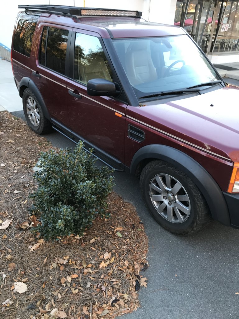

About two weeks ago it got what I like to call the Carolina lean, or tripod mode if you prefer.
The front right wheel is stuck at access height. I get the usual suspension fault warning after about 30 sec paired with the special programs off.
