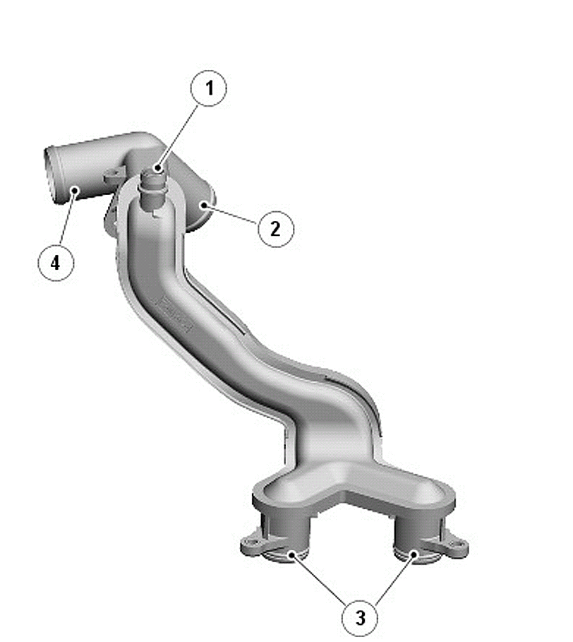

I know their has been talk about a hose associated with pump failure, is that the LR018275 water outlet?

Well my fears were confirmed. It looks to be the water outlet/front crossover. The new water pump and back pipe look fine with no signs of leaking. But the plastic crossover right above the water pump has coolant marks where the joint of the plastic is. Part# is lr018275. Has anyone taken off the intake manifold on LR4. I read the forum about the XF owner who changes out all the Plastics just wondering what differences we have. Thanks parts department locally closed for tonight hope they have it in the morning.

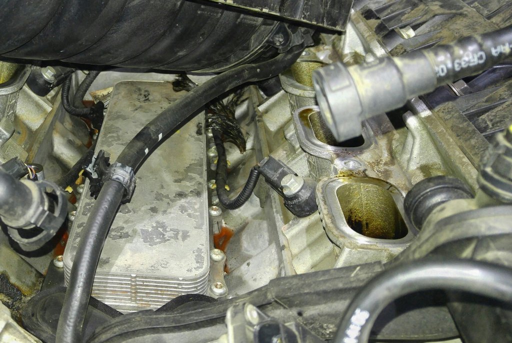

LR4 back on road:) the local dealer LR thousand oaks had all the parts I needed thankfully. Intake manifold wasn't too bad, needed to remove ten bolts, fuel crossover line and a few other vacuum hoses etc. Replaced the 8 little silicone gaskets on manifold. The culprit was definitely the water outlet/front crossover. The tech said it was pretty common on LR4, but they don't usually see the back crossover fail, supposedly it's more common on the counterpart Jaguar he guessed because of heat cycling/vent differences. Anyways take what you will from that I opted not to do it now hopefully that won't come back to bite me.

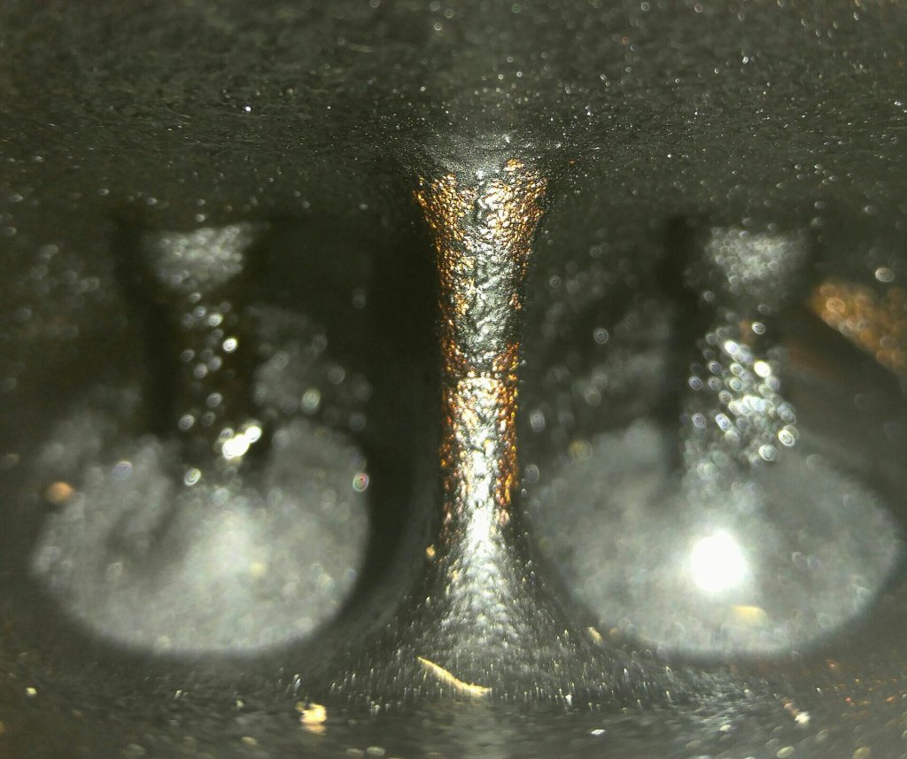

I would suggest if your vehicle has 60k plus and you've switched your water pump and oil cooler pipe this part will likely fail soon after. Tech said they don't even remove the manifold completely just lift/tilt in place. I don't even think the throttle body needs to come off. Tried to clean out valves while intake was off pretty gummy and this was after I just did some $$$ intake cleaner via fuel. I'll post a couple pics. You can see remnants of the mouse i couldn't find in the first pic.

wow great job. do you have a pic of the actual part that failed.

Thanks. Its at the bottom of the first picture I should have taken a close up but you could flex the plastic and the seam would open up 1mm or so. It was leaking above #3 at the junction corner

I was also concerned about the intake valves, unfortunately because this engines are direct injection this is very common.
