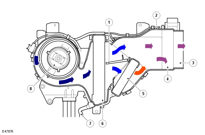

Interesting. So you're just diverting the air around the heater core for colder air, and back through it for warmer air?
I've not had mine apart, but on my old FJ-40, the valves controlled the coolant, not the air. I can see why it's harder to control coolant, though!
Here's the air flow path on the rear heater assembly.
5 is the heater core. 1 is the air diverter door.
