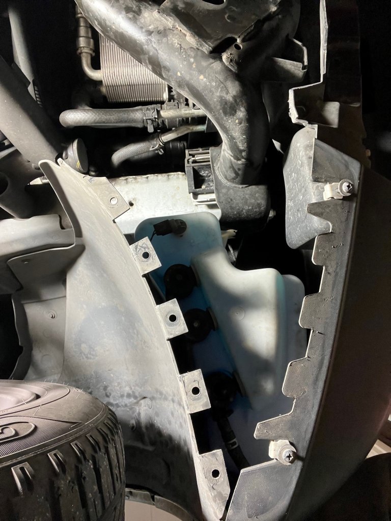

Per some of the online forums, I removed some of the plastic cowling on the bottom of the left fender/bumper. I was supposed to see the hood release mechanism between the radiator and grill but cannot (I know what it looks like and where it is but cannot see that spot based on what I have removed so far). So, here are my two options:
1) remove the left wheel cowling to see if I can get to the hood release mechanism
2) remove right wheel cowling to see if I can reach up to the battery from inside.
Anybody has any input which approach would make more sense first? Can someone look inside their L322 engine bay to see if removing cowling would allow access to the battery? Thanks in advance.

Yes - got in: you can reach in to unlatch the hood through the grill on pre-2010 models but not 2010-2012. I had to pull back the front part of the left wheel well lining and reached pretty easily from there. I could do it in 10 minutes now if I had to do it again. I also ran a wire from the battery to the grill if I need to charge it again in the future.
