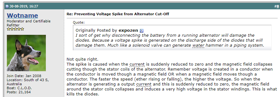

The system can put out high voltages if the battery cables and all connections are not tight.
Check all connections and make sure all the grounds are good.
From the manual for the 2013:
"NOTE: Under no circumstances should the battery be disconnected with the engine running because under
these conditions the alternator can give a very high output voltage. This high transient voltage will damage the
electronic components in the vehicle. Loose or incomplete battery connections may also cause high transient
voltage."
It seems that 16V is OK.
