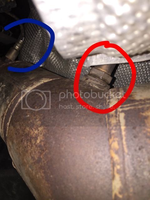

Also, in this pic, this is the passenger side...is the red the downstream and blue the upstream?
