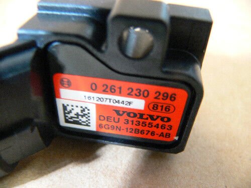

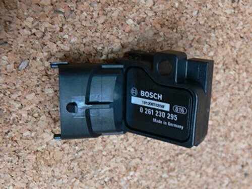

Hey Michael thank you very much for the part numbers! I was able to get behind there and found it! Took a picture and its actually a Volvo part, mine looks just like the attached RED Volvo MAP Sensor. Probably no big deal
When I went a searched for the LR021587 part number I actually found the red Volvo one AND the Bosch one that I attached a picture of as well. Guessing they will both work?
The one that, probably not a big deal, is that on the Volvo one it reads 0261230296 and the Bosch one reads 0261230295! So the same except for the Volvo has a 6 at the end and Bosch a 5 at the end. Any idea if this matters at all?
Thanks again and really appreciate the help as I'm not experience mechanic but just willing to do what I can myself to save some money and learn!
