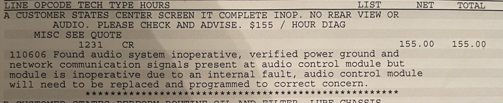

At the end of the day, if Mozam’s solution would work and it would save me even more cash, it would be great to keep it stock and keep all of the functionality. I just don’t know enough about what I actually need. I found the diagnostic info from the dealer and I tried to insert the picture, hopefully it works. Maybe you guys can decipher it.
To me, it seems like if I replace the screen I will still have the issue because the module is bad. I could be wrong, happens a lot!
