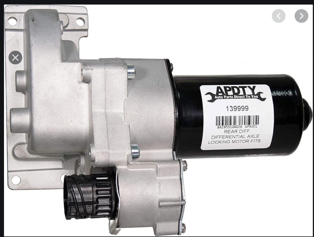

Hello,
Saw this on Amazon. Couple guys said it works Anyone try adding these motors?
Thanks,
Sean

My LR4 did not come with a rear diff. Can you add one to a vehicle that was not equipped with it? (LR4 2002)
To the OP: are you asking about adding just the motor for the locker or the entire new diff? I'd be wary about buying a part so vital off Amazon without knowing the part number and compatibility.

Looks to me like it might be a no-name/off-brand replacement motor for models with optional locking diff.
If you are asking if this will somehow upgrade your non-locking diff to locking... nope.

So you need this piece and the motor?
Differential Assembly - Land-Rover (LR041063)
and a whole lot more...all the wiring the control module, etc. I think someone did a write up on here of a conversion using a diff off of a parts truck. Not a plug and play.
