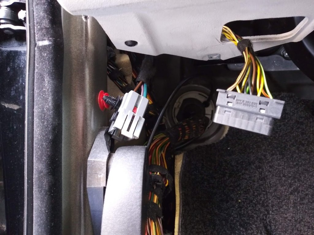

For what it's worth, here is a pic of mine; 2011 Range Rover. It was on the left side, tucked into the bulkhead. It was not visible just looking up there. I took the dash apart except the air bag looking for it. Worth the effort, using the Ford style adapter the controller was plug and play.
