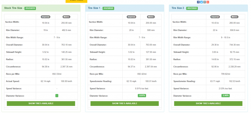

The 22" wheel/tire combo has shortened your gearing 2.5% . Add in a less fuel efficient tread pattern and construction (I am going to stretch and say 5% over a good highway tire like a Michelin Latitude or eq). This could account for a 7.5% reduction in fuel economy. It may knock you down about 1.5-2.0 mpgs.

@ktm525 I've had the 255/55r19 Goodyear Duratrac on before these issues started to occur. In matter of fact, I was averaging well above 16 mpg and getting around 20 mpg at best. I don't believe the the tires are at fault. I rotate them and fill them with nitro air at least every season, except when I have to air down and fill with regular air from a Viair 400P.
