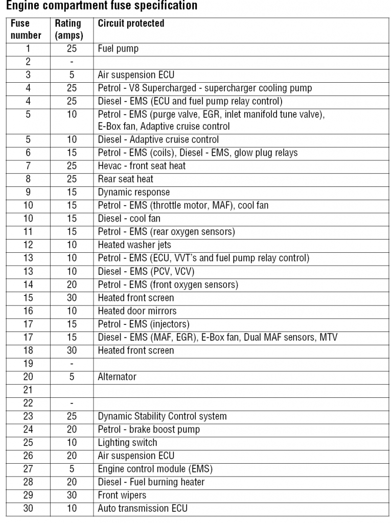

Do you have an owners manual? Normally fuses and relays are located by the battery and under the dash on the passengers side of the vehicle.

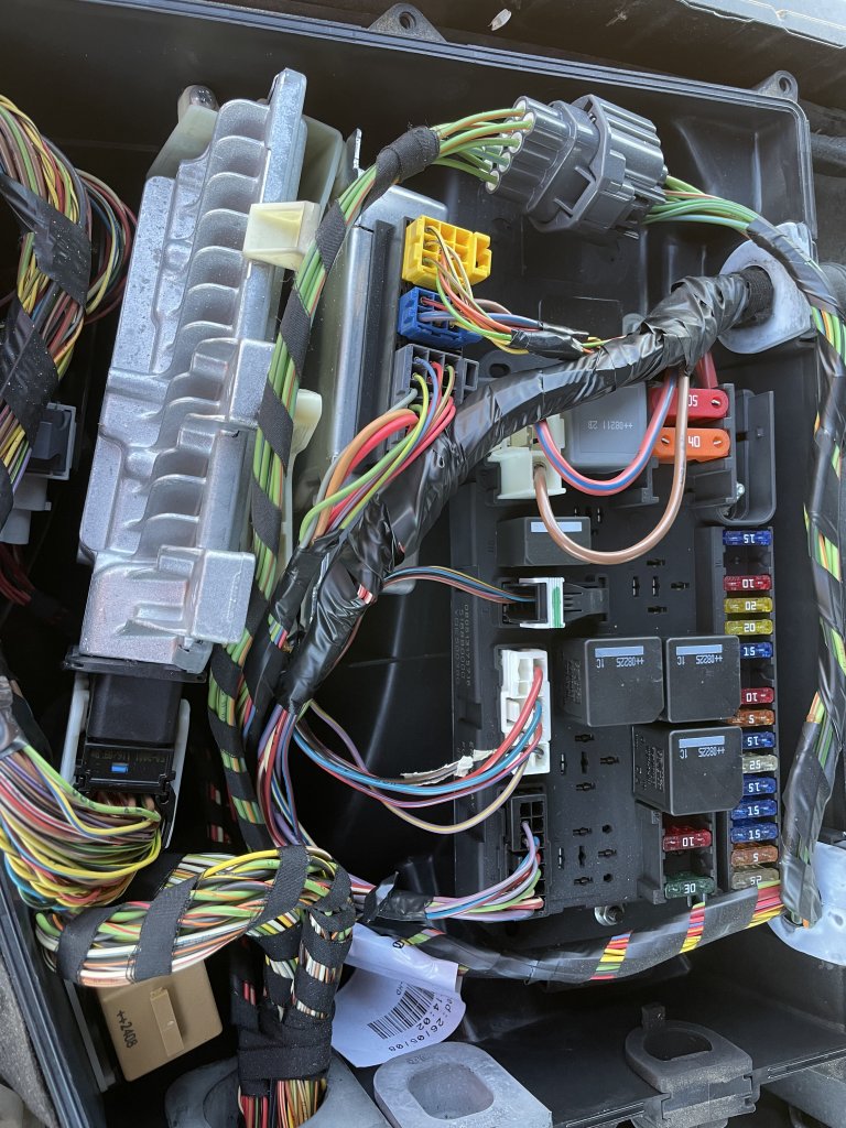

I’ve checked engine bay, and all the 25A fuses.
But the fuse legend you show has 30 fuse positions, mine only has 20 ?(as photo)
So can’t be certain what I’m checking .
