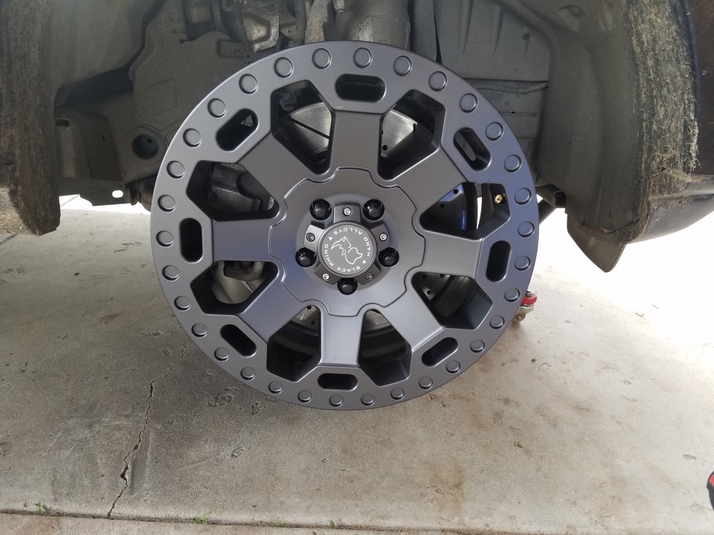

MY2010 LR4. After doing a lot or research I went with the Black Rino 18" Warlords. The lift was set using Gap Diagnostics IID Tool that was purchased from Lucky 8. The tires are BFGoodrich All-Terrain T/A K02 275/65-18. We have put over 50K miles taking trips, towing and going off roading with no issues. So far we are on our second set of tires.

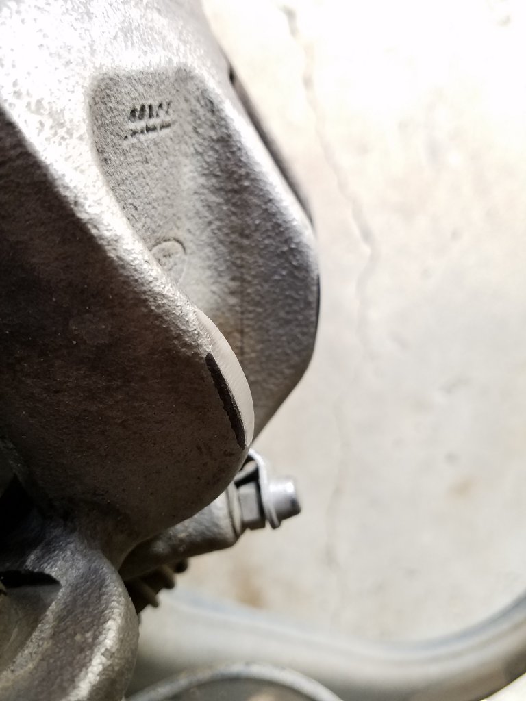

When first test fitting the wheel, it would hit the fin on the top of the caliper. For peace of mind, I bought a used front caliper off eBay and cut it in half long ways across the fin. The fins were solid, and I decided to grind them off to allow the wheel to fit. No more than 3.0mm was removed on the fronts and 2.0mm on the rear. At this point the wheels fit and did not hit any part of the caliper. The wheel weights do have to be placed as close to inside or outside edge as possible to clear the caliper. I used Toyota style Lug nuts with extra length on the shank. It has been a while, but I believe the thread were M14x1.5 which require a minimum of 9.5 turn thread engagement. Because of the 275/65-18 being a larger tire, the frame horn had to be shortened and re-boxed. This LR4 came with the factory rear electric locker. This option came with a full size spare in place of a donut spare. It is a tight fit and the air has to be removed from the tire, but the spare 275/65-18 will fit underneath. The research took time but the process was easy. This may not be for everyone but it has worked for our set up and opened up wheel options.
