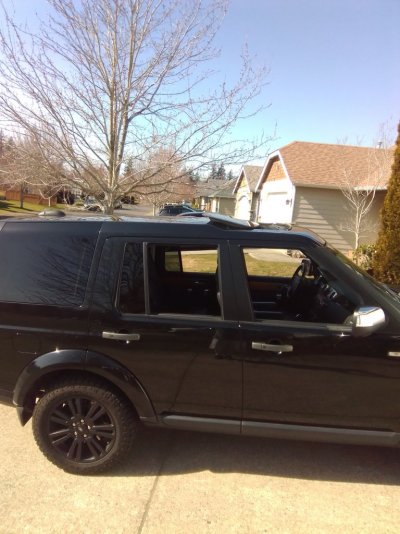

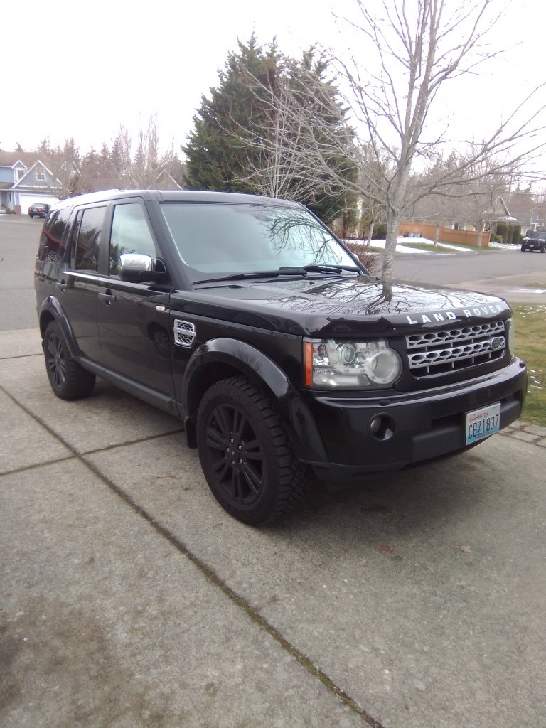

I have the Duratrac. Here is what they look like on my 19" wheels.
