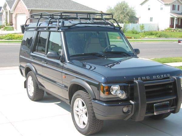

I finally got the rack mounted!
I dipped the feet and clamps in liquid rubber last night and put it on my Discovery this morning. I may strip the liquid rubber off of the clamps (puts a little too much bulk on, my door just barely misses hitting the bottom of the clamp), but I will take care of that a little later.
Here is a picture...

I think that looks SWEET! Good purchase.

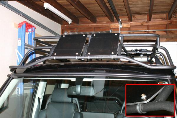

I recently had to take a highway trip with a client. I wanted to reduce wind noise quickly. A quick trip to Lowe's and I whipped up 2 quick wind dams. I now have minimal wind noise even at 80mph. (function before fashion here) I am keeping them on just cuz my Jeep buddy does not like them.
Chris, what are all of the materials that you used to create your custom air dams? The noise is horrid with my new rack once I reach about 60 MPH.

Your rack looks great! Yeah they are loud.
Here is my process:
created template from posterboard. cut out plexiglass to shape.
A trip to Lowes to get the following:
Rubber lined 1" pipeclamps, 1/4 Neoprene Washers, 1/4-20 x 3/4 Socket Head Cap head screws. (4 per panel) Need some 1/4" nuts too. The Socket Head Srews will rust soon. I was just going to touch up with some paint.
I cut out the patterns with drywall cutout tool with all-purpose bit. I sanded the back side of the plxiglass, then spray painted sanded side flat balck. Drilled holes and mounted.

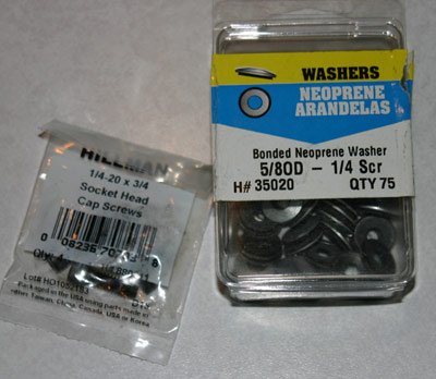

I will try and get better picks soon. Here is a pic of the washers and bolts purchased from Lowes. I am sure you can find same stuff from somewhere else. This is just what I created.
There is still noise. Nothing like before. I might have added some wind noise with my RockyMounts bike racks I just added.
