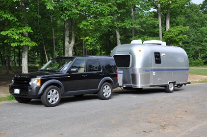

I agree on the look of the combination, here's my LR3 towing the Bambi...
