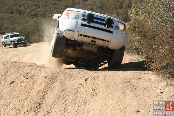

Very cool...Doug? I have these same cheezy Land Rover 55w off road lights and am very dissapointed. What are you using? they sorta look like Light Forces, but the photo is not clear.
I'd be interesed in the mounting plate as well.
