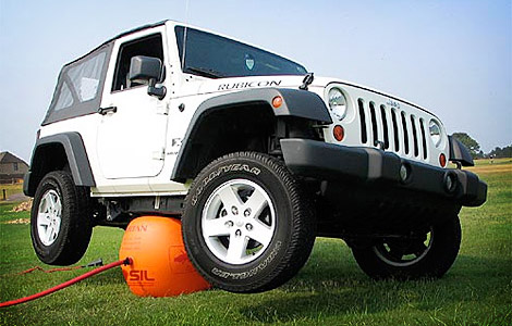

Perhaps a better option for the LR4 is an exhaust jack. They are sold under the brand names of X-Jack and Titan. Perhaps other names too.
