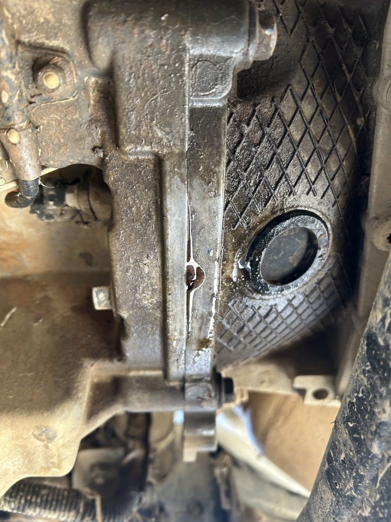

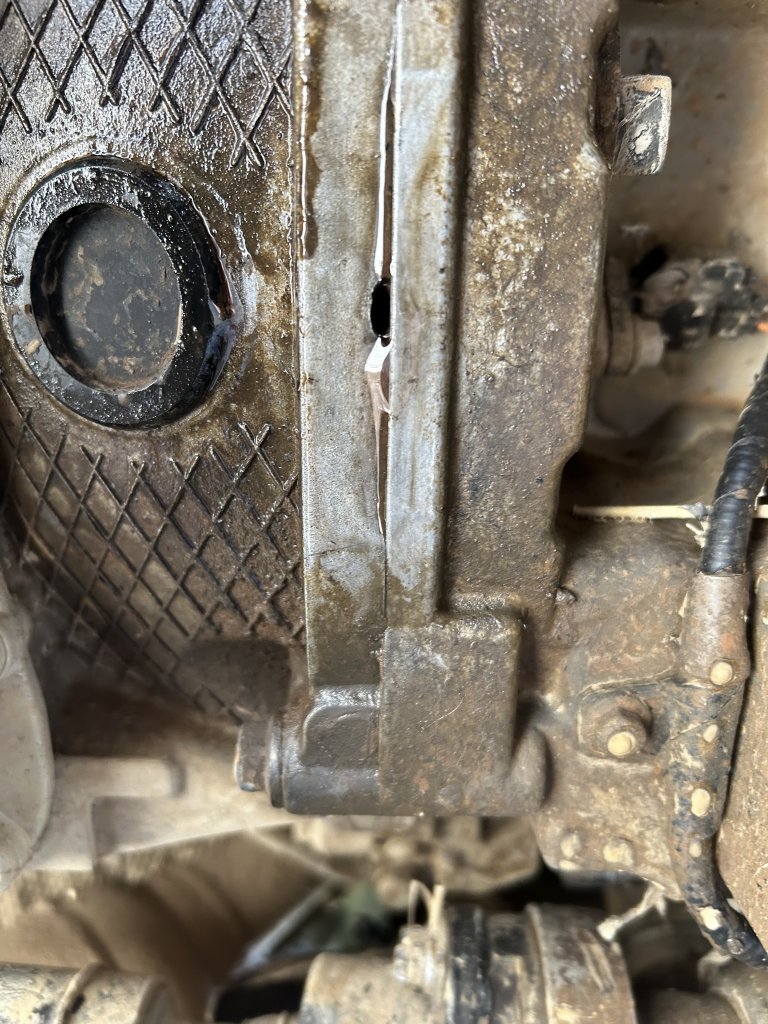

It looks like my transmission is leaking and it appears there is a small hole. Is that hole supposed to be there?
I was off roading and my front left cv axle broke, I am curious what else could have gotten messed up.
I can provide more pictures or details please just let me know.
Any help would be greatly appreciated.
Thank you

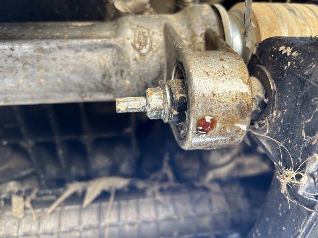

I also saw some fluid here, but was unable to see where it came from.
I have wiped it all down to see where more comes from if it hasn’t all leaked out yet.

Top pic is the transmission front pump seal leaking.
Bottom is probably residual fluid from the CV axle being replaced.

Looks like it was leaking long before the CV axle failure.
No, transmission won't be damaged from CV axle failure.
