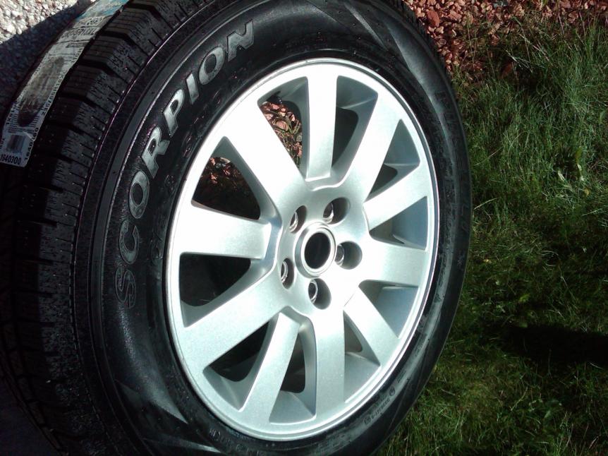

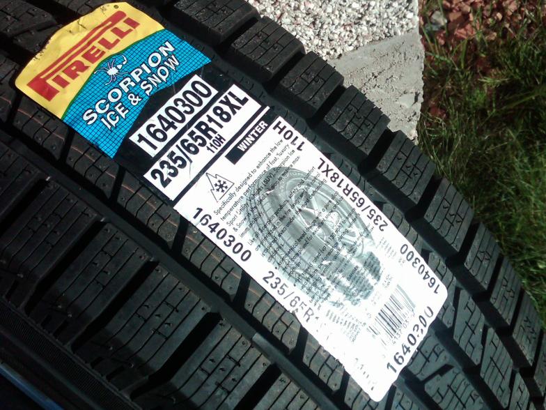

My winter tires are the narrow taller 235 65 R18 XL"
I am debating going back to a narrower tire due to the apparent adverse effect on mileage of my 285, May go to 275 and see if there is an improvement, unless I find a willing victim to swap wheels for a week to see if it makes a difference for both of us.
How does 235 sound for narrow?
The 235 65 R18 XL is a 30" OD tyre factory rated for the 3. Maybe for sand, wide is good, but for mud and snow, I think narrow and tall is better.
Narrow and tall might even be better for rock as well. To me, wide only works on the track and maybe the autobahn.
