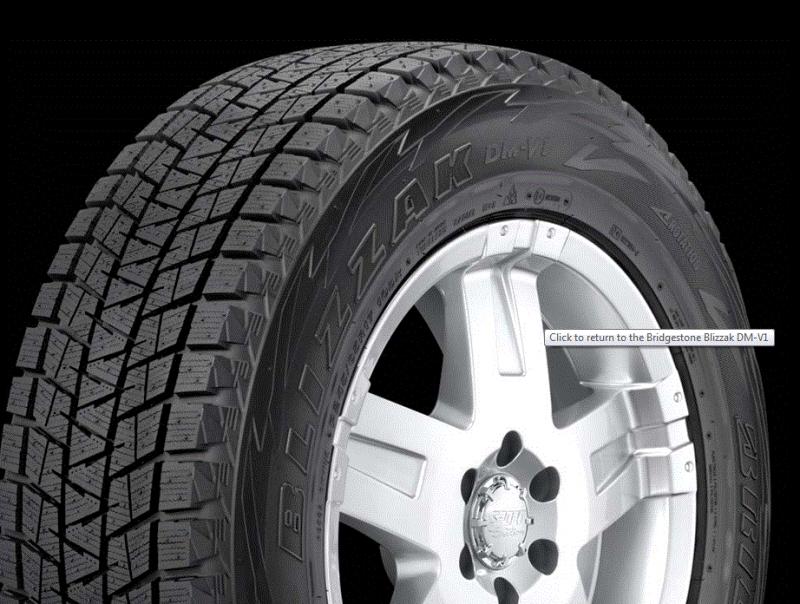

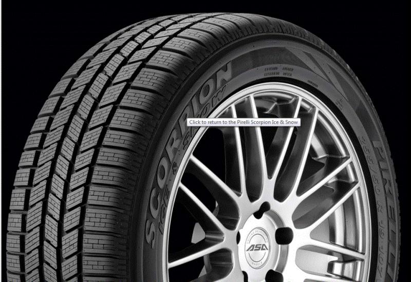

I found some online pictures of the Bridgestone Blizzak DMV1s (preferred tire) and the Pirelli Scorpion Ice & Snow (what I have now).
You can see the 90 degree angle on the Blizzaks versus the rolled edges on the Pirellis. Both tires are excellent on ice, but the Blizzaks are just amazing in deep snow... The perfect "bring it on" winter weapon!
Good luck, and enjoy your LR4!
-Blake
