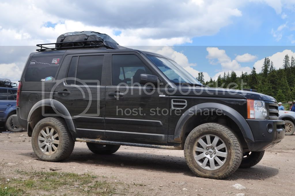

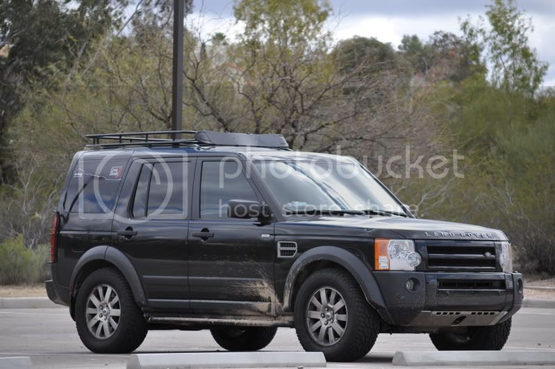

Great advice from cbboard. I have a similar setup. I made a point to find the HD package for the rear locking diff, but it was very tough to find in California. Ended up getting shipped down from NoCal as there were none in SoCal at the time. (I had an '06 before without the rear locker and I notice a significant improvement.) Traded the 19's for Cooper Zeon LTZ's on 18" stock wheels, Rover Specialties Stage 2 sliders (like them better than slim or Stage 3 personally) - I also have the underbody protection plate on the front. Rovers North is the only place to get the non-winch version in the US. Others are making knock-offs for less $, but Rovers North sells the original Mantec one that LR dealers sell in Europe. It comes in handy off road and can really take a hit. I also have a set of extension rods that I only use off road. They raise it another 2-2.5" at every setting. It makes a noticeable difference on the tougher rocky trails. Last thing is a Brownchurch low profile 3/4 roof rack. I just like the look of it, and it's plenty of space for my needs. I didn't want a full length rack. I'd like to add a ladder just for fun some day, but really don't need it. Inside, I carry a Viair 440 for airing back up after airing down for the trails, and to fill up my deflated spare if I ever need it.
Here's a pic.
Here's the new off road height with the rods.
