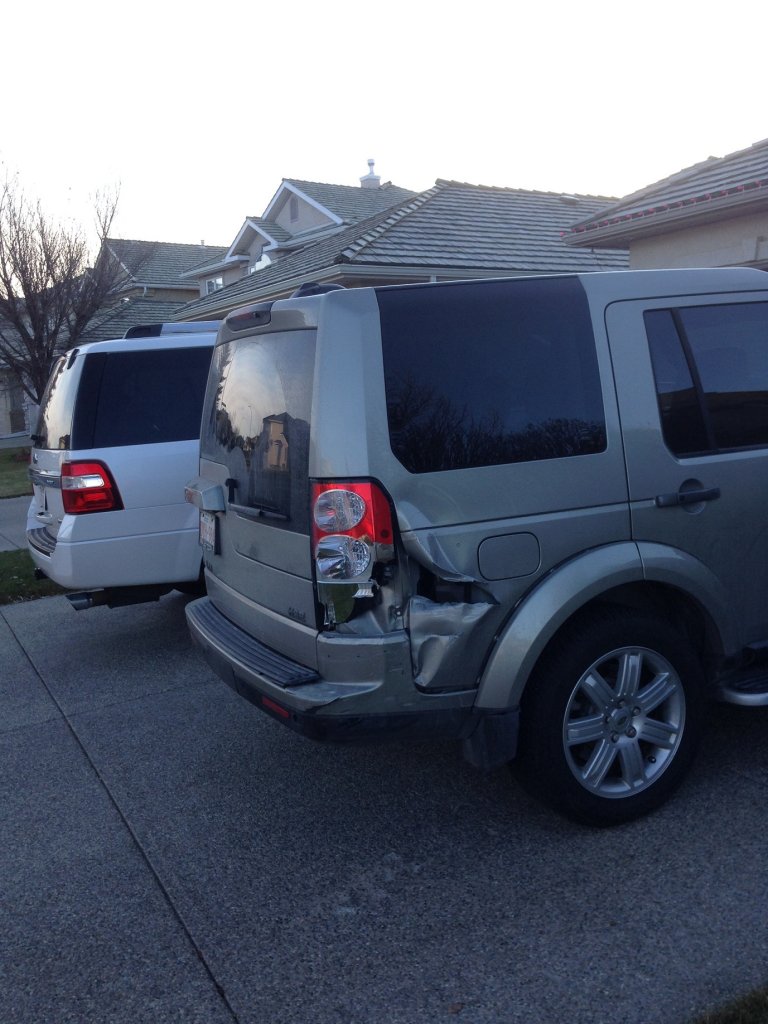

$16k worth of damage in a fender bender lol. That rear quarter panel is expensive and ships from the UK. No aftermarket body panels.View attachment 10180
Damn Bro, that's crazy $16K. On the brighter side it looks like the tailgate didn't get damaged.
Hell i'd be in a Pick-n-Pull of other wrecking yard with a carbide 4 1/2" wheeled cordless grinder and cut out a quarter panel section larger than what you need by 1". Study and make the proper cuts to fit with NO GAPS a butt joint replacement panel. Tig or Mig welded in a stitching procedure moving around not warping the sheet metal. Time and labor on you, painting to match at a body shop. Hint, use a body shop using the same manufacture of paint that was used on the LR from new as then the dyes will fade evenly over time. You should be $14,000 to $14,500 ahead when all done JMO. That's how i'd resolve it if it were my LR. Almost forgot, this a steel or aluminum bodied LR? Aluminum well a bit harder to Tig vs steel......~~=o&o>.....
