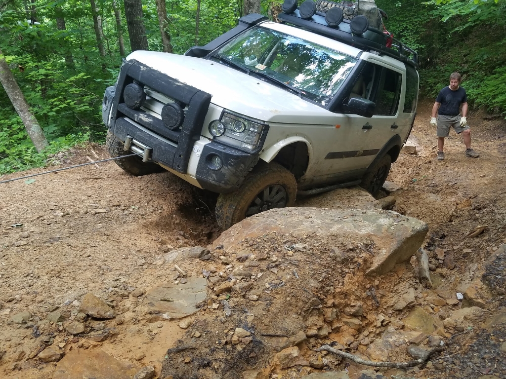

To get it ready:
OME HD Springs
Maintenance
33x12.50R18 Atturo Trail Blade MT
Factor55 ultra hook and fairlead.
You need to consider though my truck already had
Proud Rhino Front Bumper
TerraFirma sump and transfer case skids
Proud Rhino gas tank skid
TerraFirma rock sliders
Pro-Speed UK Roof Rack
Coil Conversion with TerraFirma springs
LED bumper fogs and Warn HID lights
Awning
Fuel Cans
CB
I won’t be competing next year but I will likely do the event. One of my friends has asked me to join him so I will if duty permits. I honestly could care less about where I finish I just enjoy the adventure of the trip.

Cool story/trip! Why'd you choose that wider tire vs something that would tuck in better like a 285/70-18 which is almost 34" but with a section 11.5" ? It's perfect on an 8" wide wheel.
After test fitting a few sizes, I landed on that size for factory wheels that fit right in amazingly using the lucky8 strut tower spacers which allow 100% full flex without any fender flare issues. No rub issues in any trail situation.
I won't ask about the springs because that's a very tired pro/con personal choice really. I've wondered about strut spacers on top of the steel spring kit but the axle angles might get too close to a dangerous limit for reliability.
