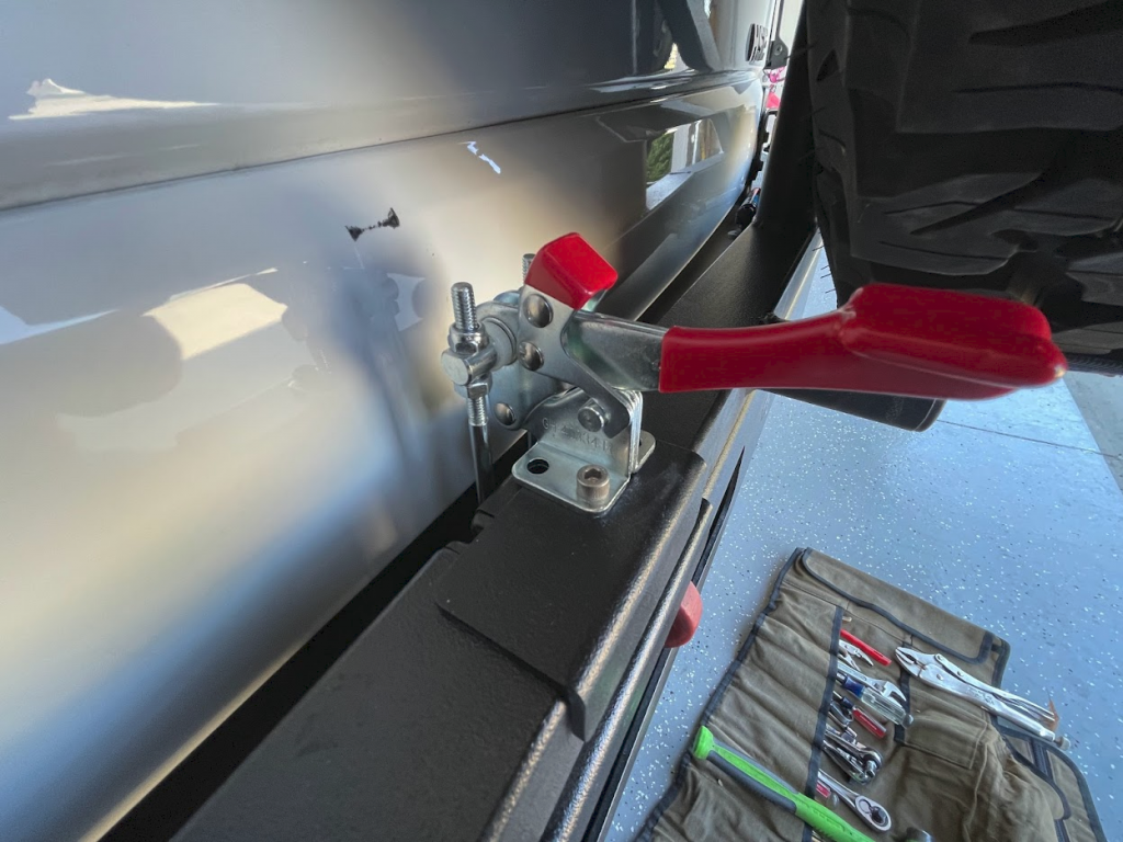

I got one of the newer T44 latches (had to upgrade from the original one since I bought it years ago). They use this version now. I find it pretty easy to use. I put a zip tie on it to keep it aligned perfectly with the hook (otherwise it has a little side to side movement). The way it locks on is really nice now, spring loaded latch thing.

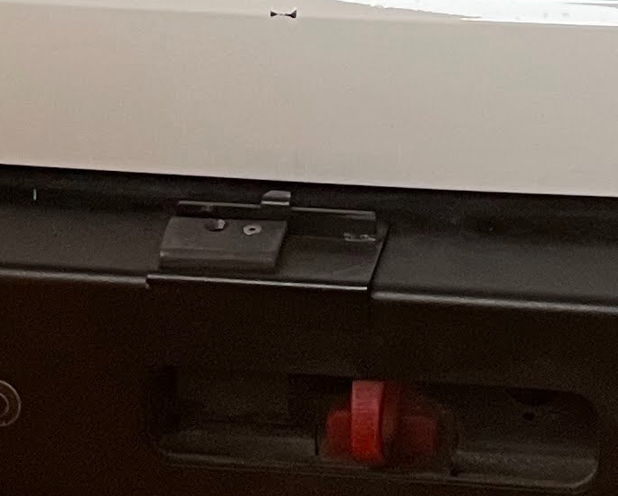

That's identical to the latch I have, but the mount itself is a little different from yours. I find I have to lift up on the tire mount a bit to get it to go over the friction block/strike plate. Although I haven't tried grinding a ramp onto it yet.
Also, note the gaffer tape on the tailgate: if it weren't there, the latch would occasionally hit the paint and scratch it up as you release it, because it's under tension.

I have an older bumper, so the latches they were using were smaller. The new ones are friggen massive and I don't know why he felt the need to upgrade them. My latch arm is also different because I have the dual swing version so it has that extra plate that catches the second arm also.
I don't have to life up my arm to get it to go onto the pad. You have to adjust the mount plates around the mount plates around the main hinge bolt to adjust that. I had to drill a different hole in my plastic pad thing because it wasn't setup to support the dual swing. Probably just an oversight by T44.

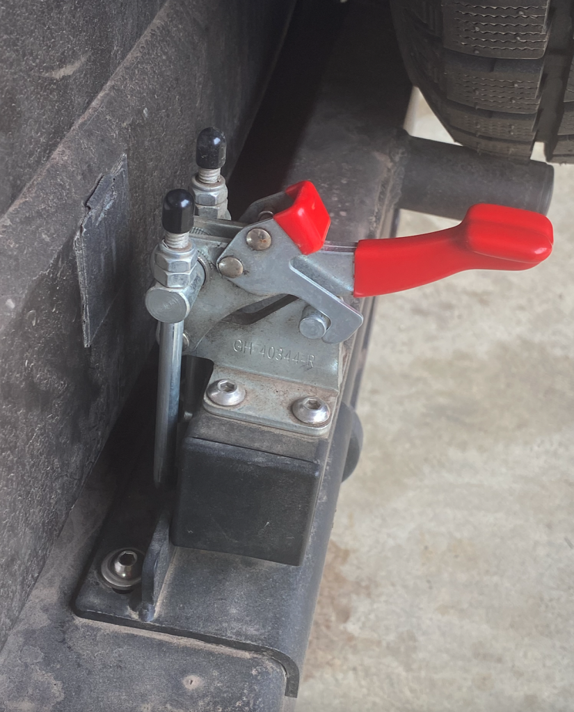

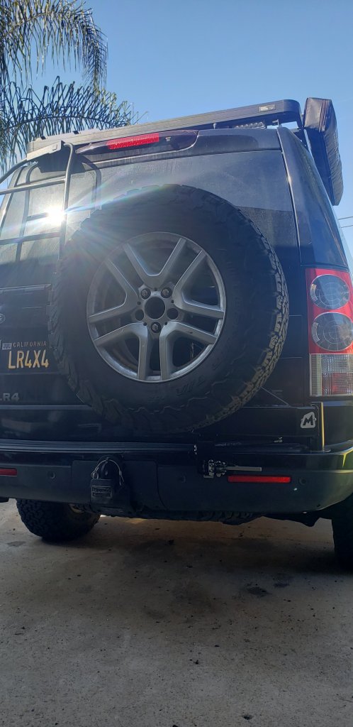

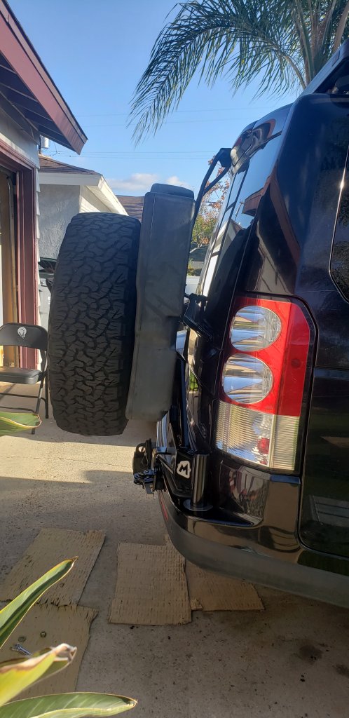

I have the Terrafirma one and it's nice. The strut definitely was a nice touch to help swing out and keeps it there, but it only swings out about (guessing) 95°.
The latch is simple enough that my wife and kids can latch/unlatch it. I put a tiny pin in it to keep it from accidentally popping out, never an issue. It's easy enough for daily access.
The tire carrier doesn't have a weight capacity limit. I have an email thread with a vp level at Terrafirma and Lucky8 with me field testing a full 15 gallon fuel tank and a 255/70r17 KO2 spare tire hitting the trails hard without any issues. I didn't get any compensation or anything.
