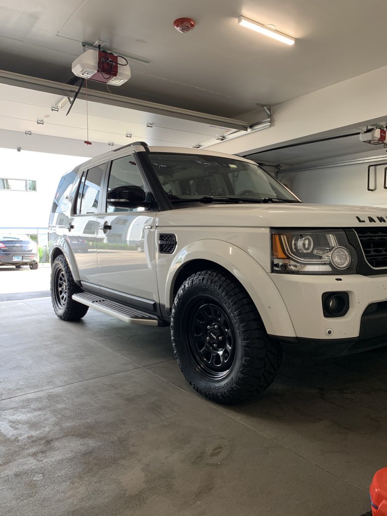

TuffAnt, who I'm currently leaning towards for 18" wheels, suggests there might be some "slight rubbing" in "full lock" and "when new," which is a fair number of variables.
265/65 R18's with TuffAnt MKII ET27's on Nitto Ridge Grappler here. What TuffAnt has told you is exactly my experience. My Ridge Grappler's were brand new and in full lock to the right it would rub on the frame horn (sounds weird at first but it's not doing any damage to the tire/vehicle). Oddly enough, it doesn't really rub on a full lock to the left. Not sure what that's about, but YMMV. I personally notice I rarely full-lock on a trail anyway, it's only in city/urban driving where it happens more often.
