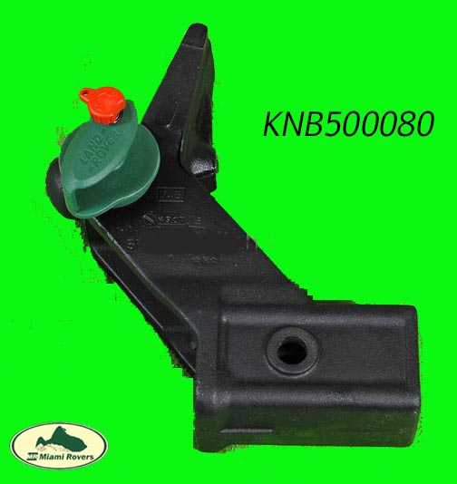

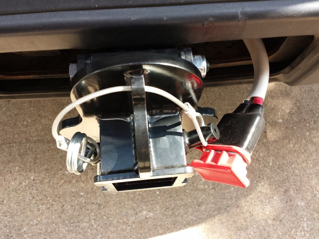

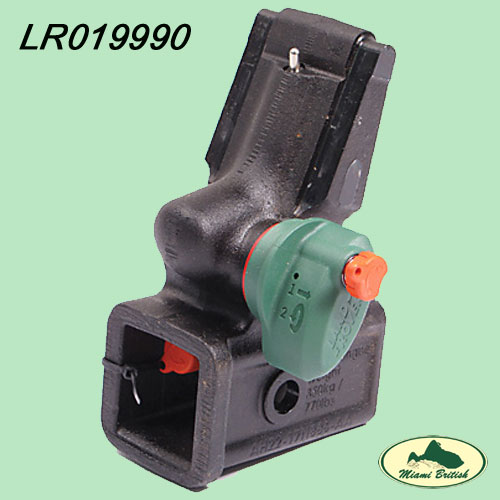

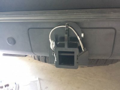

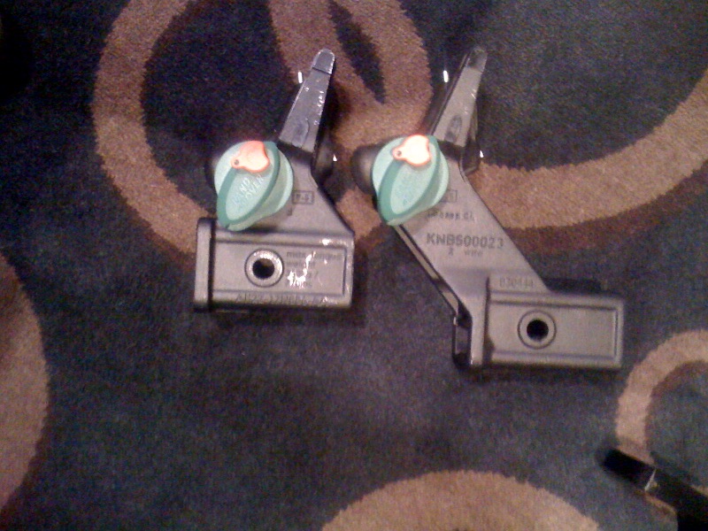

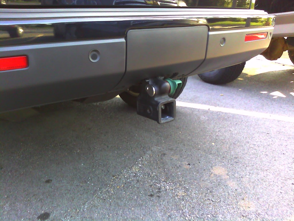

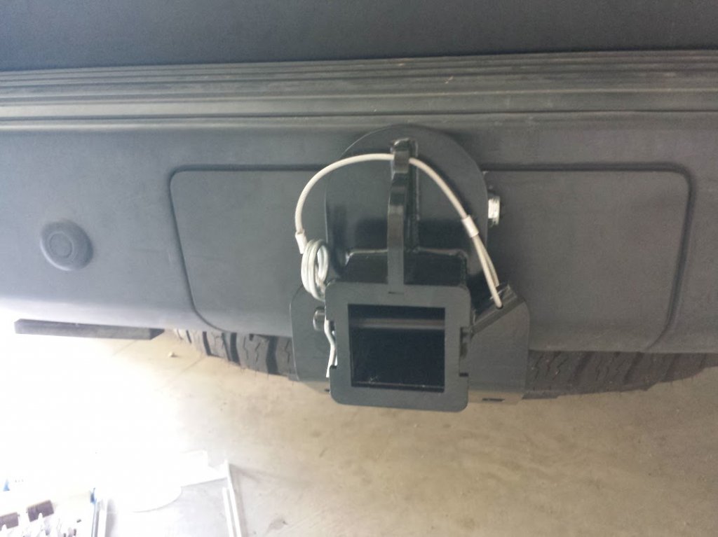

Attached are pictures of the original LR3 hitch and the newer LR4 hitch. Both work on either vehicle.
The newer LR4 hitch is less long and apparently has an improved locking mechanism.
Regardless of which one you use, remove it when not in use as when sitting inside somewhere, it is not subject to rusting or freezing itself to the vehicle.
For real off road trail use, I would be using the bolted in place bumper level Rhino hitch.
It you are driving an LR3 with the incandescent tail light bulbs, I would suggest the trailer have matching incandescent bulbs in its lights. That avoids the funny flickering you get when you mix the two - also the trailer program will engage in the LR3 which among other things, disables the backup sensors.
LR3 and 4 NAS trailer hitches original and newer.jpg LR3 Female Receiver long one part number KNB500080 orange key.jpg LR3 Female Receiver stubby one part number LR019990 red key.jpg LR3 Female Receiver stubby one plugged in.jpg LR4 new short style hitch.jpg

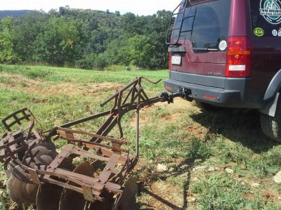

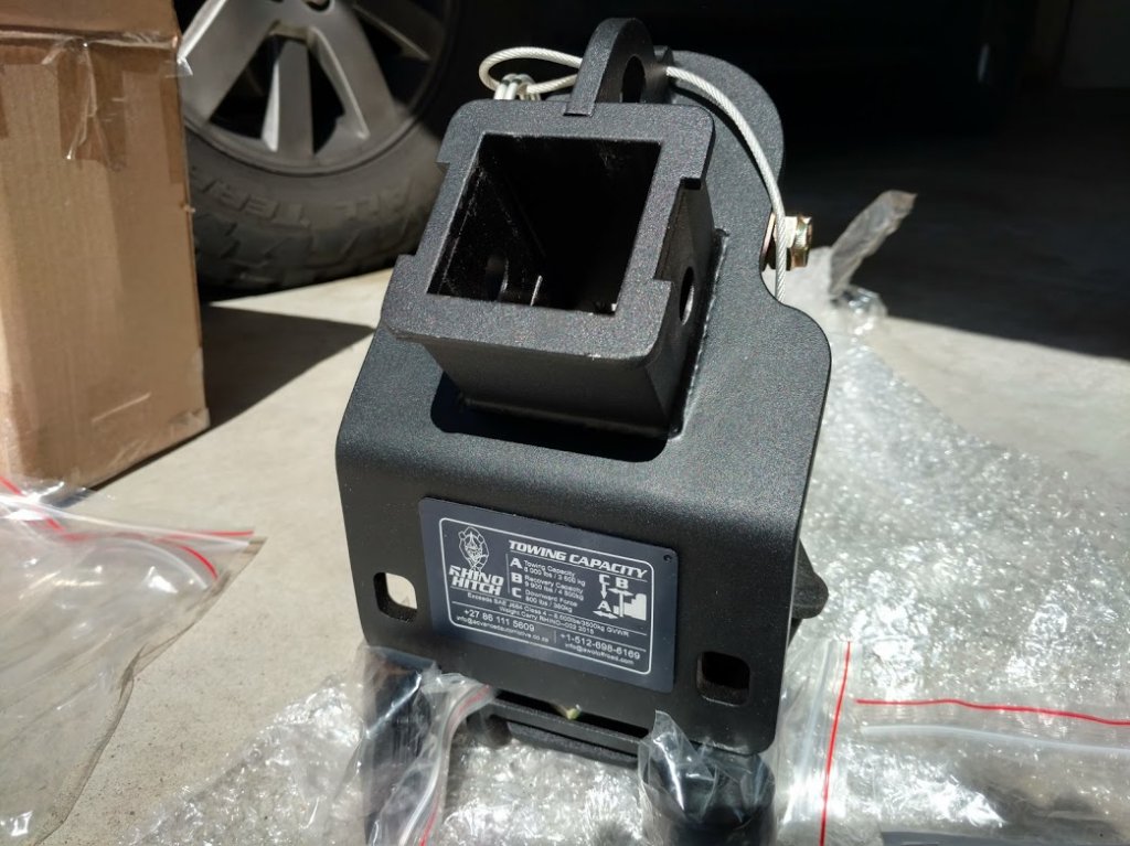

For equal time and all, below are some Rhino hitch pictures which is for real off road use. The factory hitch I regard as more for U-Haul type trailers.
Disc behind LR3 using Class IV Rhino Hitch.jpg Hitch veiw end mounted on LR3 20150612_155706.jpg Hitch vew top looking down mounted on LR3 20150611_170200.jpg Hitch view end looking down at sticker powder coat finish.jpg
I have a Rhino and really like it. Have you ever used it during a recovery situation where you pulled someone out of trouble or got pulled out yourself? I know that one of its attachment points is the cast factory recovery point on the rear. I just wonder if anyone has used it to get yanked out of trouble. I have not and would probably recheck the torque values afterward if I did, just to be careful.
