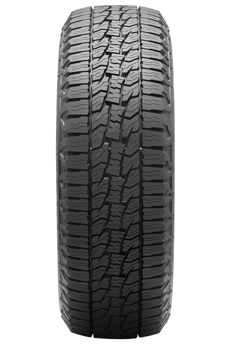

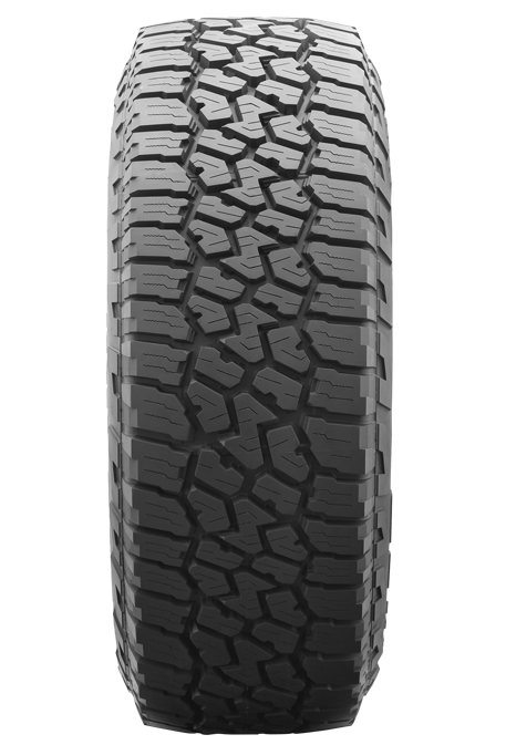

AT Trail will be better in winter than the AT3. Tires with bigger lugs like the AT3 tend to clog with snow. And the AT Trail has far more sipes than the AT3 for better traction & braking on ice.

I don't know if there are more sipes, but there is definately less room for snow to pack in between the lugs, and a lot of what we get here is heavy/wet slushy snow, which packs hard. They may perform better in dry fluffy/granular snow. I am about due for tires myself, so I am on the fence between another set of AT3W, the AT Trails, or something different. I have never had the same set of tires twice on the same car, I just can't seem to help myself from thinking there is always something better to try!
AT Trail on left, AT3W on right:
