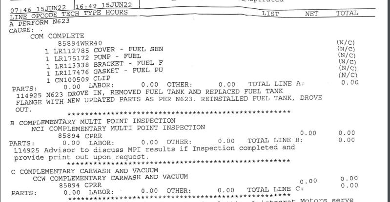

Here is what parts were changed on mine pursuant to the recall:

I'm scheduled to have this done in a couple of days. I am still confused about what all gets replaced in that assembly.
Especially the fuel filter: it feels ridiculous to me to have the filter on top of the tank, but I gather that's the only one. Is it part of the assembly, or do I have to request that they replace that as part of this process? Also, should I have the low-pressure pump replaced, or is it also part of this assembly?
1,858
LR175172 was replaced on mine. Invoice says it's a fuel pump, but a google search doesn't turn up much.
EDIT: a post on Discoweb says that part number is a filter. No idea, though.
greiswig
Mar 1, 2021
625
260
SW Washington
I had this service done yesterday. No great surprises, but I was able to talk to the service tech about what all got replaced as part of this. The assembly is really just the filter, and the LP pump is a separate part in the tank and was not replaced. He said that at 50k, he wouldn’t replace that anyway. No issues so far, but I haven’t filled the tank yet so I’m still crossing my fingers.
