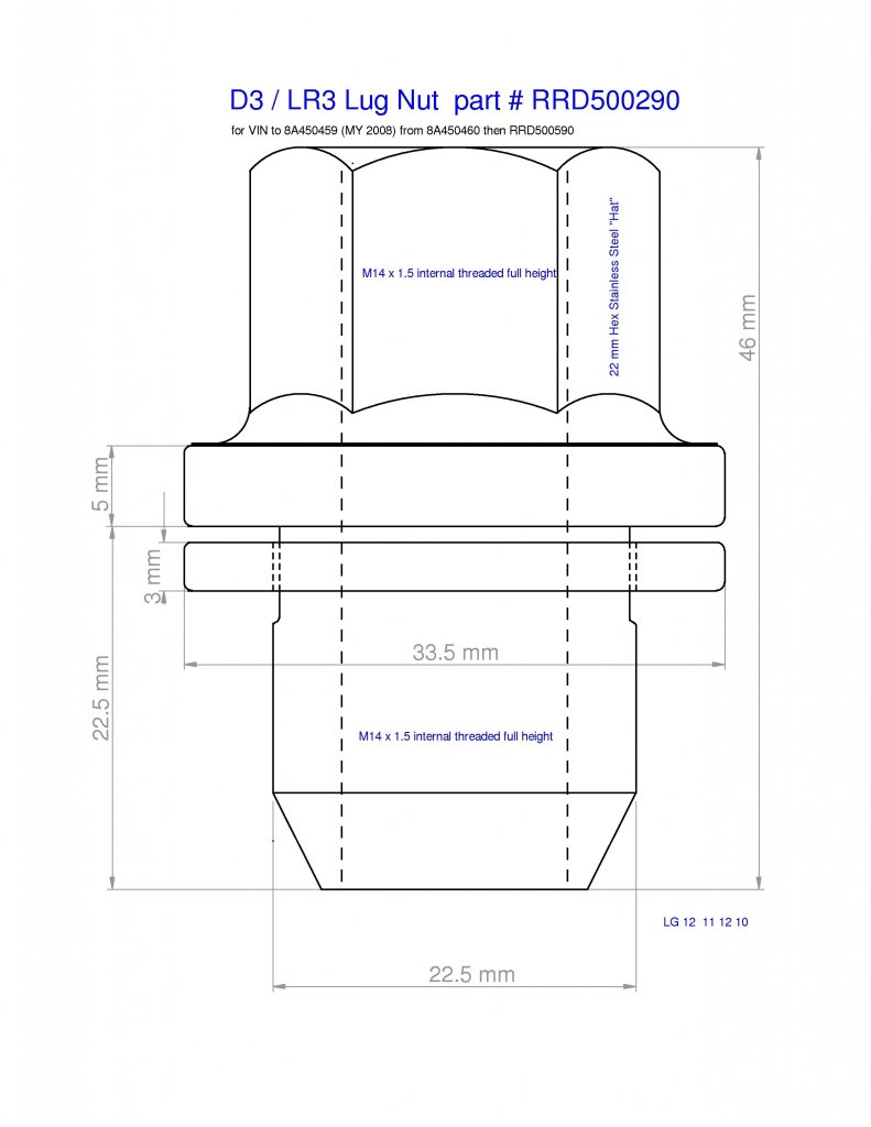

M14 x 1.5 is the correct internal thread.
The link below is to a metric drawing of the lug nuts for my LR3, the same as the jpg attached but with more data.
I think they are the same for the LR4.
The inch drawing in the post above appears about correct.
The important item is the "washer" that is fixed to the lug nut.
https://www.disco3.co.uk/gallery/displayimage.php?album=3801&pos=23

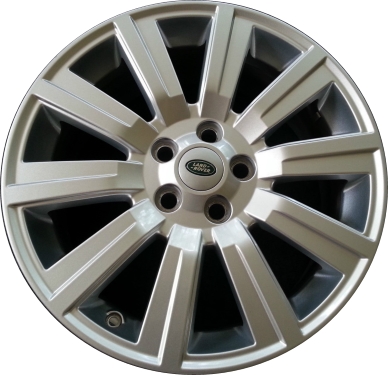

I have thoroughly confused myself searching the forum for guidance on which size Gorilla chrome lugs I need for my 2013 19" rims (pictured). Is it 75148R or 75147RB? What do they mean by bulk vs bag? I need a full set of 20.
Trying to see if I can find them on Amazon and take advantage of any Prime Days savings. TIA!
