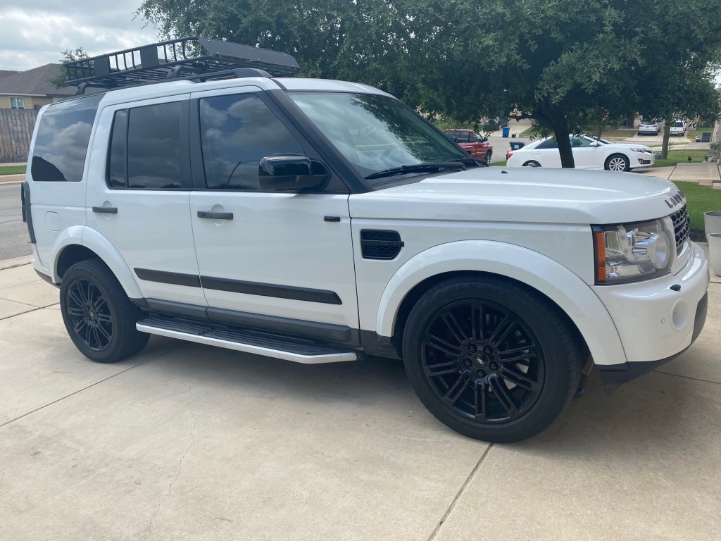

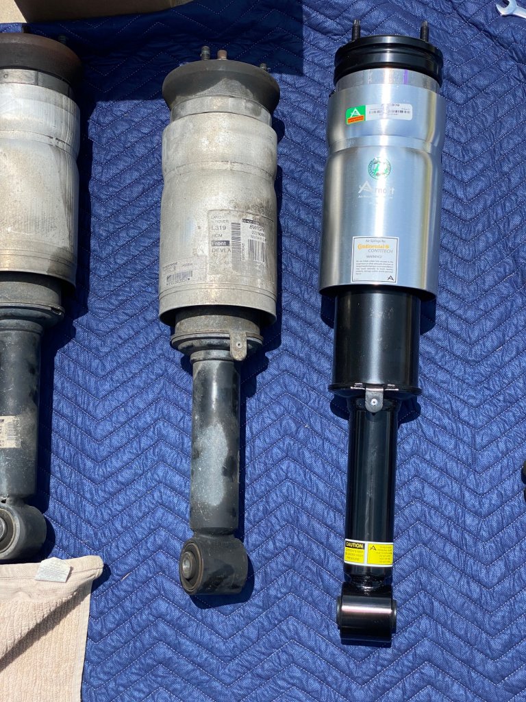

Regarding the EAS and the LR4 sagging in the front. Past few times I have parked the car I have listened to the front struts and it does sound like air is being released in a leak fashion.
As suggested I put the vehicle into off road mode and then pulled the EAS fuse #10 from a diagram I found.
I again heard a slight hissing again from both the driver and passenger side front springs, I believe it was coming from the top near the air fittings. When I came out in the morning both the passenger and driver side front sides were near the bump stops. It seemed the passenger side was ever so slightly higher than the driver side.
I feel like both fronts are leaking and have gone ahead and ordered x2 new Arnott AS-2809 front air springs in hopes this will fix the issue.

So I was able to swap out the air springs today and I am pretty certain the front end sagging issue is resolved. Its been a few hours and the car has not sagged where as before it would sink in the front within 10-30 minutes. Also the hissing that sounded like a leak is no loner apparent. Unfortunately I am getting an intermittent suspension fault for C1A13-64 (2E) Pressure does not decrease when venting gallery. Looks to be this is related to filters inside the desiccant dryer attached to the compressor pump or the exhaust valve being clogged. More troubleshooting to come. Happy the front stays put now at least and these Arnott have lifetime warranty.
