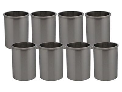

Just one example of "Top Hat" liners securing the liner never fearing of failed head gaskets along with liner slip issues. Another company with "Top Hat" liners that also have O-ring groove in the liner preventing coolant into the oil should the block's thin coolant passages have any fractures which is rather common with later production 4.0 and 4.6 blocks. Going this far might as well go for a 4.9 stroker crank. No matter a 4.6 or 4.9 engine fuel it properly with a Mark Adams chip. Hell this chip wakes them up, runs better and cooler plus will pas strict Kalifornis SS smog sniff test with ease. Hell the "Tornado" chip has been installed since late 99. Also the Pre-Oiler, my engines live counting by hundereds of thousands of miles not tens of thousands of miles. No butchering installing 350 Chubbie engines in LR's I now read on LR forums. Yes i'l marked as a "Hot Rodder", at least it's a LR engine that pulls off idle not revving with great street manors a fexible engine. Not into peak Hp numbers being usless for daily street driving including stop and go traffic.......~~=o&o>......
