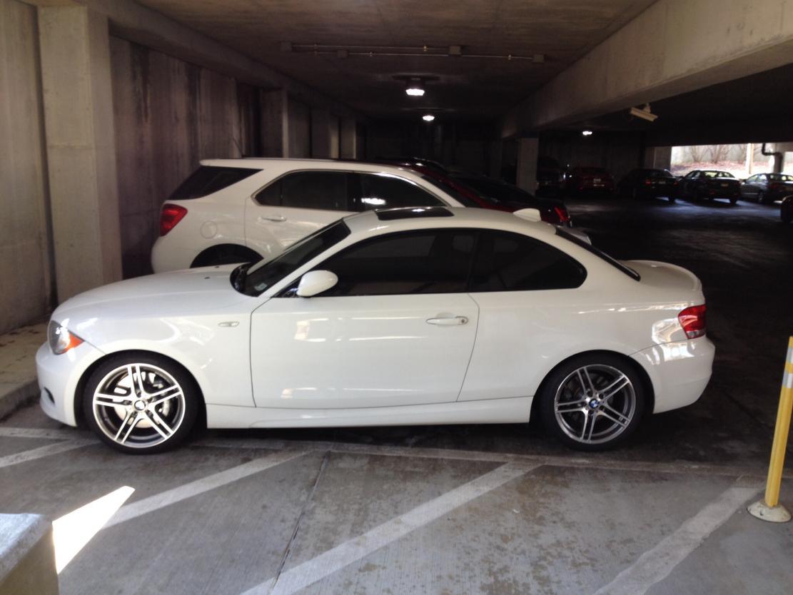

Installed my fogs today. It was 70 out :cool:
plus she even gotta a vacuum
Plus …plus……I drove the 135 to work. :proud:
……. first time driving the little beast in almost 2 years :biggrin:
It's good to be home !
:tongue:
