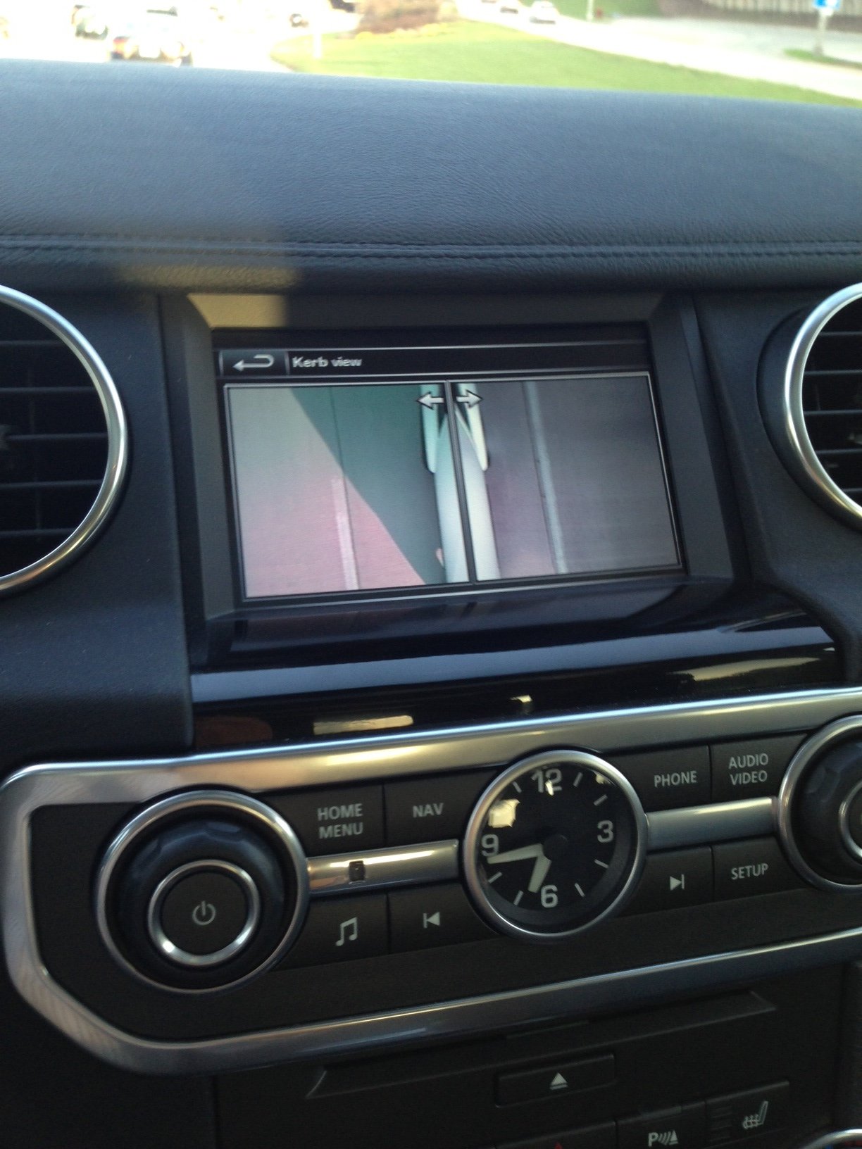

I guess the forth time is not a charm... So the left wing mirror camera is half pink.
